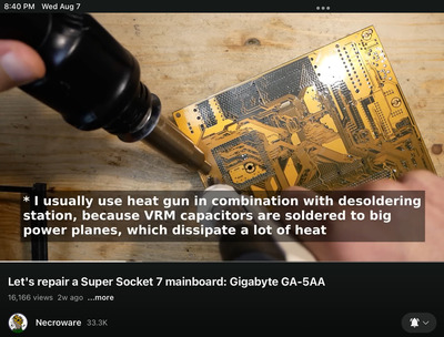

Reply 7 of 21, by zuldan
Been mentioned in the posts above but I'll say it again. A heat gun + desolder gun (vacuum) works perfectly every time. While heating up the hole with the heat gun, use the desolder at the same time (after a few seconds). It's the best way to do it I find with the least about of stress to the board.

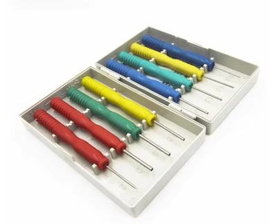

My WEP 929D-V solder sucker came with a long stainless poker for clearing holes and 4 diff size tips, it has worked very well. Yeah tried the compressed air method once and will not do that again 😁

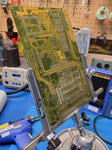

This is my final resort trick too - fresh solder added on each side, hold the board up vertically somehow, and then attack from both angles. It's a bit awkward but always gets the job done.
This is precisely why I use this circuit board holder. Makes tackling desoldering from both sides trivial.

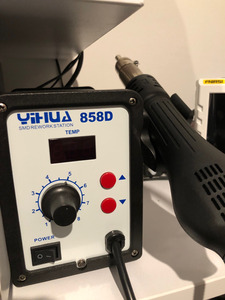

Which kind of heat gun do you use? I only have one with large exhaust (older model of Bosch GHG 23-66).
Any pointers where to purchase the circuit board holder from? It looks good.
I think I'll order smaller tips for the desolder (DX112, DX110) and try them too. Further testing with throwaway MB indicate that desoldering component wires with larger diameter are easier than with smaller diameter using my DX113 tip.
I use this cheap chinese one. This is the best heat gun I've ever used. The heat it produces is amazing. You can find them on eBay.
