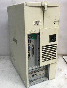

I want to replace the extremely limited motherboard in my Dell Dimension L1000R with one that has pci, isa, and agp slots. It would preferably have either a pentium 2 or 3. Games from the Doom era to the early 2000s 3d games are the target. I need plenty of ide. A 3.5 floppy connector is necessary and a 5.25 floppy connector in addition to the 3.5 one would be epic. I would add a Diamond Savage4 pci and an Sb Live! 0060. I might also add this 3com ethernet card.

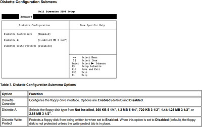

Same with the floppy connector. A single floppy connector should accommodate two disk drives, so if you want to install a 3.5" drive and 5.25" drive, that should also be fine.

Computers such as your Dell often have proprietary motherboards, power supplies, etc. that make them poor candidates for a motherboard swap, and a look at this image from Ebay seems to confirm that. IMO your best bet is to leave the Dell alone and shop for a different Win98 computer, maybe even sell the Dell and use the money to buy something more appropriate for your needs.

I also recommend starting over in a standard ATX case instead of trying to swap motherboards.
I do remember DELL at one point having power supplies that appear to be standard ATX, but have a different pinout. If you do intend on continuing, make sure your DELL power supply uses a standard ATX pinout. No need to start another thread on how you burnt your house down.
Cables with both 34-pin (for 3.5") and edge connector (for 5.25") are readily available. You have to check whether the BIOS supports dual floppy drives. While most retailed Socket 370 MB supported dual floppy drives, some OEM systems supported only one FDD, and your current Cayman-based Dimension L1000R was one of them. Check the BIOS setup section of your candidate before finalizing a purchase.

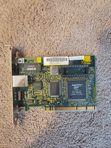

Unless your room is highly humid and free of static electricity, putting any PCB on carpet would be a bad idea. A glass surface would be ideal, followed by wooden and thick cardboard.

No need to worry about MB connectors; focus on chassis instead. At very least, your configuration will need at least two external 5.25" bays, one external 3.5" bay, and two internal 3.5" bays.

Agreed, and I would add another point - the Dell L series is microATX or close enough. You're not going to build a great ~1999-2001 setup with the amount of slots you get on microATX, not to mention I think enthusiasty boards back then were all (or almost all) full ATX.

Seconded. As I wrote in my previous reply, the MB was an Intel CA810 (Cayman) with numerous OEM cut-offs. It was meant to be an office computer or a basic browsing / email platform for grannies.
