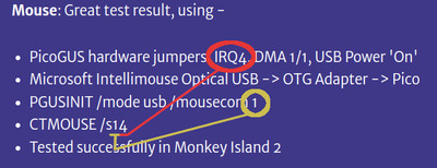

I briefly tested the USB function of a v1.2 card.
Joystick: No result yet. Gamepads are getting power, but I haven't figured out the right config to get any input to DOS software, yet. Or the pads I tried may not be compatible. It may be a good topic for somebody to cover with a Youtube video.
Mouse: Great test result, using -
  • PicoGUS hardware jumpers: IRQ4, DMA 1/1, USB Power 'On'
  • Microsoft Intellimouse Optical USB -> OTG Adapter -> Pico
  • PGUSINIT /mode usb /mousecom 1
  • CTMOUSE /s14
  • Tested successfully in Monkey Island 2

Thanks for some feedback, and good to know that you were able to get the mouse working with that configuration. I will try to give it another go with the mouse once I have a moment and try out a similar configuration.

Good luck, let us know how you get on. You can change the COM port and IRQ parameters if wanted.

I had a moment to give this another go tonight. At first I tried everything you suggested with high hopes it was going to work. I was thinking one thing for sure that I missed before was setting CTMOUSE /S14 instead of /R2. I was still struggling to get it working and was about to give up, then I decided to try the mouse plugged into my modern PC (Logitech G502). To my surprise it worked right away!
The mouse I was originally trying to use was a wireless mouse with a 2.4ghz USB dongle. I didn't think it would have any issues with this because I have used this wireless mouse for other micro computers with no issues. But it seems PicoGUS / Pi Pico does not support it. Overall this is fine and it is good to know that the issue is not with the PicGUS or OTG cable. I am going to try out /joy and some gamepads again to see if I can also get something to stick there.
Thanks for the help and encouragement!

If I continue booting to Win98 and have it scan for new hardware, it does find the new MPU401 (and it's usable), the new COM3 and a serial mouse attached to it. However, the mouse on COM3 does not work in Windows. And if I reboot to DOS mode, it is not usable under DOS either. If I detach the serial mouse from COM 1 and remove it from device manager, then I have no more mouse in Windows (or DOS) even after rebooting.
FWIW, the mouse I'm using attached to the PicoGUS' USB port is a Logitech M720. It works fine everywhere else. I don't have another USB mouse to test with unfortunately.
Am I making a glaring mistake, or is this sort of wireless USB mouse just not supported?
