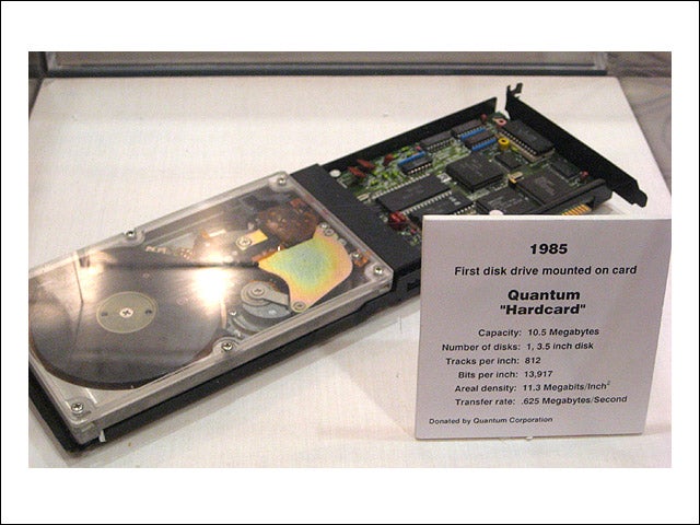

Reply 14 of 23, by wierd_w
Indeed. A common trick BITD was to put a RODYNE or RACORE hardcard in one of the slots, and use the AT case.
Another, was to replace the full-height 5.25" floppies with half-height ones with a little metal bar connecting them, then do the same thing with some winchester drives in the second bay (when using an XT chasis, which has the same board hole-pattern)
The more radical and extreme out there, would have used a SCSI card and an external enclosure.
They made versions that were hella-beefy full-height drives stacked on the controller card. Old AT chasis used to have little plastic support slots in the back of the case to help support these very hefty cards.
