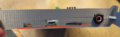

Hi, I just received my new PicoMEM, love the project and I am hoping to put it into a heavy use soon!
I am looking at the 3D-printed bracket, I might want to model my own version (with a hole to install a 3,5mm jack for the audio option). While looking at the included bracket (and the STL file), I noticed that the board sits in an angle (the two mount posts are at different heights, but also at an angle). This seems deliberate, what's the idea behind this design?
Reply 187 of 475, by Yoghoo
lausvi wrote on 2024-08-15, 20:10:
I'm not the author of that bracket so I don't know. But I made a separate bracket as I had the space and not a 3.5mm extension cable. Maybe it can be of use. You can find it here: https://makerworld.com/en/models/454339?from= … rofileId-361872
Reply 188 of 475, by FreddyV
wowbobwow wrote on 2024-08-15, 00:29:
EDIT / UPDATE: I fixed it! I manually set the PicoMEM's NE2000 port to 380 (I'd already tried 300, 320, etc.) and now it's working beautifully. I'm probably dumb and didn't realize that it might be conflicting with the QuadRAM QuadBoard that came in this system - does that sound right? Either way, I'll leave this post for posterity - I hope it helps someone else!
Hi,
Yes, I wrote in the FAQ that if you get a MAC with 4 times the same value, it is a Port conflict problem 😀
Hope you like the PicoMEM 😀 Do you have the DAC on it ?
Reply 189 of 475, by FreddyV
Hi,
Yes, it is deliberate to have all the connectors not to close to the edge.
If we don't do that, we can't insert the uSD and USB cable.
Reply 190 of 475, by lausvi
FreddyV wrote on 2024-08-16, 06:20:
I meant the red line in the attached pictures: the board is not parallel to the bracket:
The attachment bracket.jpeg is no longer available
This is how I plan to install the audio output jack:
The attachment 20240816_173028.jpg is no longer available
Reply 191 of 475, by MJay99
I don't have this card or bracket, but I'm guessing it might be the overlapping parts of the case's slot that would be getting in the way of the connectors, if they're not bent away like that.
Reply 192 of 475, by weedeewee
lausvi wrote on 2024-08-16, 14:36:
I meant the red line in the attached pictures: the board is not parallel to the bracket: […]
OMG.
I had a look at mine with the same 3d printed bracket, and yep. it's supposed to be that way, sadly enough. It seems there is no other way to get enough clearance for the connectors & µSD card slot when installed in a the pc case.
Do not ask Why !
Reply 193 of 475, by FreddyV
Yes, this is it, it is on purpose.
The uSD and USB connectors are too close from the PCB.
These kind of connectors did not exist at the ISA time
