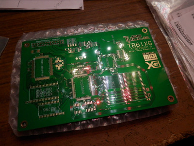

Reply 50 of 70, by Tiido
I am actually in the process of preparing to build stuff by putting together a big parts order from Mouser, and now with this reminder I'm making sure I have some parts for these boards too ~
I'm not quite sure when exactly when though I'll be building stuff, school started again yesterday and that order will take a number of more days to actually compile up but I think sometime in the next month I'm gonna be ready to do some conversions ~
    695.67 KiB
    1191 views

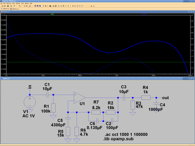

Reply 52 of 70, by Rawit
Tiido wrote on 2019-02-19, 23:14:
giving option to follow same EQ curve as original module or flat output (SPDIF only has flat output)
Do you have to know the default EQ settings of the DB50/DB60? Amazing project btw!
YouTube
Reply 53 of 70, by Tiido
I simulated it years ago but have forgotten what the result was. This option is gone in this final version (TB61XG), however, along with ADC functions.
Reply 55 of 70, by Tiido
I have resimulated the circuit and it has a small bass boost and a small dip near 1kHz for "crisp" sound :
55.32 KiB
1009 views
LTspice simulation of XR712/XR385 output
There is a bit of uncertanty with the capacitor values, due to tolerance factor and some difficulty measuring but these are the values that I got on the particular board I was doing stuff with.
