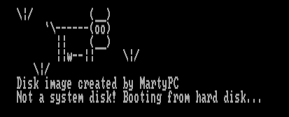

Yesterday I implemented track formatting. Besides just being generally required for full emulation of the FDC, it also now lets you create a pristine, formatted bitstream image within MartyPC of a specified standard size. Complete with a custom bootsector based of C H Hockstaetter's ubiquitous code.
Maybe I should commission VileR for custom ANSI cow art...
4.75 KiB
1176 views
MartyPC's custom bootsector
