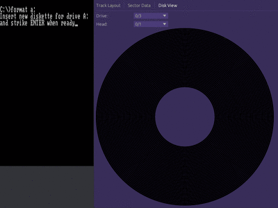

I've finally plugged in fluxfox's disk visualization into MartyPC's GUI.
This allows for some cool stuff, like watching a disk get formatted (animated gif):
The attachment format_viz_06.gif is no longer available
