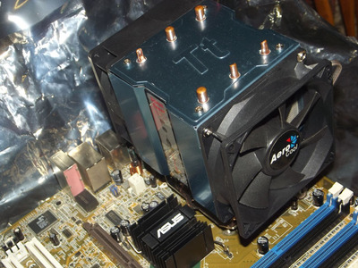

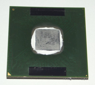

Is burdened around 50 degrees Celsius, not warming, Delid CPU+ThermalTake.

But anyway, I set it to 3.8GHz for use, just the big clock to the summit. 3.8 This specimen is almost cold, as if it were cool, a selection of D0.
