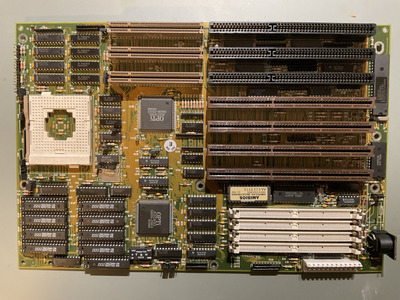

Hi all,
I got this OPTI Hunter (82C691/696) VL/EISA Board and need the cfg file for configuration.
Does anyone knows the Manufacturer, the name and/or has the cfg file?

Reply 1 of 6, by Disruptor
Basically when you run an EISA configuration utility (ECU) it says which !???????.CFG it needs for that mainboard.
Perhapy you can find out which .cfg is needed?
Reply 2 of 6, by PC-Engineer
Found it in mr_slugs EISA Archive under OPTI 407

Reply 4 of 6, by Anonymous Coward
Can you share your BIOS please?
It’s a very odd board for the middle of 1994. Maybe TMC/mycomp?
Reply 5 of 6, by PC-Engineer
Here ist the BIOS file. Maybe someone is able to find out the manufacturer.

Reply 6 of 6, by Anonymous Coward
40-0101-001343-00101111-111192-EISA_LC
The third set of numbers contains the manufacturer ID, which in this case is "Shuttle".
This board seems to be undocumented, but you might be able to figure out the model number by digging though old usenet posts.
