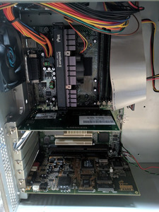

Upgraded my KG7-RAID's main drive to a 74GB Raptor on a J-Micron SATA-IDE adapter that I did a resistor mod on.
file.php?mode=view&id=204591
This thing officialy FLIES. 🤣

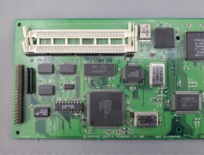

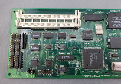

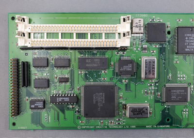

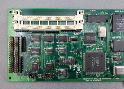

Swapped a couple more damaged RAM sockets on a pair of Sound Blaster AWE32 cards (CT3900 and CT3980). […]
Had a bit of a panic when the CT3980 didn't seem to be recognizing the installed RAM. Spent about 30 minutes checking continuity, reflowing solder joints, etc. Until I finally realized I had forgot to set the jumper to enable external RAM. 😅
Before:
The attachment AWE32 CT3900 old RAM socket.jpg is no longer available
The attachment AWE32 CT3980 old RAM socket.jpg is no longer available
After:
The attachment AWE32 CT3900 new RAM socket.jpg is no longer available
The attachment AWE32 CT3980 new RAM socket.jpg is no longer available
Those new ones look far better, I also had to swap out the SIMM sockets on my CT3670 a while back since they were both broken. I did think that a 3d print would work to hold the SIMMs in place but then found some good replacements, but not metal clips like you have there so I treat them very gently.

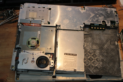

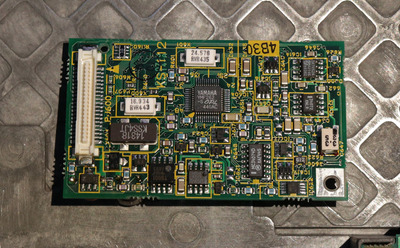

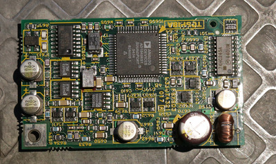

Today I put my Toshiba T4850CT back together for hopefully the *LAST* time. It's been apart for capacitor replacements, floppy drive repair multiple times because 3d printed belts aren't perfect. 3d printed replacement parts had to be made for missing parts. The soundcard has given me so much trouble - I recapped the sound board since it had one of those Elna 6.3v 1000uF stubby caps that goes bad on just about every Toshiba from this era but it wasn't that that was faulty. (I had good reason to suspect it though, just fixed a T4700CT with no audio which was bad caps on the audio board...)
In fact my recapping of the sound board broke it for a while. Now I'm using a 560uF polymer cap in place of the original 1000uF to fit the height requirements of the sound board. The little electrolytics in plastic boxes have been replaced with MLCC caps so they won't go bad over time.
The attachment T4850CT-soundcard-front.JPG is no longer available
The attachment T4850CT-soundcard-back.JPG is no longer available
The ridiculous part is, I started recapping the sound board because it would go BZZZZ from the speaker sometimes after playing a game for a bit. Which would persist after a restart and made me think there was an electronics fault. There was corrosion all throughout the inner casing with corrosion evident on the speaker area too and although I recapped everything, it turned out that the little 0.5w 8 ohm 36mm diameter 4.4mm height mylar speaker must've had a point where it could get stuck in low resistance.
Those are pretty cheap to replace even though I did need to sand down the plastic frame of the new speaker to get it to fit the very limited height requirement of the original speaker:
The attachment T4850CT-faulty-speaker.JPG is no longer available
Sounds great now and hasn't gone into that BZZZy state since.

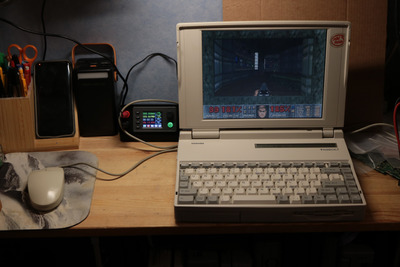

So at long last I can actually play a game on it without the sound going messed up. Sadly this T4850CT is no perfect example, there's a big scratch on the polariser layer of the LCD which I might fix in the future but for now it's not causing much of a problem in use. Actually using this laptop is quite nice, it feels quite premium for its time since it can charge the battery while running and shows the remaining battery life on the status LCD.
The sound though, well it's a Windows Sound System with FM capability (the T4700 / T4800 are WSS with no FM) so it's not very soundblaster compatible. Running wssxlat gets audio part-way in that it can do sound in Wolfenstein 3D and some other games but there's no digital audio in DooM. This is where having a frickin ton of Toshiba laptops helps, I remembered that my T4900CT has the same WSS sound setup and could give sound in DooM, albeit only in Win95. It seems that Microsoft made a more extensive WSS translation layer / software / driver in Windows 95 which works well with DooM so there's digital audio and FM music all working well and reliably, but it comes with a speed penalty, I had to run DooM at a couple of notches smaller screen to get playable frame-rates:
The attachment T4850CT-playingDoom.JPG is no longer available
Tried out FastDoom for a bit but that really does not play nice with Windows 95 or the WSS translation in either DOS or Windows, so it's classic Doom only after all.

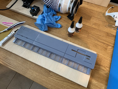

Glued together the printed parts for my “new” front bezel, looks OK so far. To be honest, I imagined the 3D printing stuff to be less cumbersome and more precise with less warping, twisting, etc…
The attachment A1K++-fb-glued.jpg is no longer available
Next up it’s time for some plastic putty and grinding, one of my favorite activities - not 😒.

Different materials behave differently.
PLA tends to print very easily, but is prone to sagging and warping if it gets even the slightest bit warm after printing.
PETG prints "okay", and has good thermal tolerance after printing, but tends to "NEVER LET GO" of glass build plates.
ABS is abysmal to print, and I would avoid it like plague on principle. In theory it makes stronger prints that you can vapor smooth. I my experience, it's just a waste of money.
Nylon produces strong and flexible parts, but wants to warp, creep, and "elephant foot" like crazy unless you use a heated, temperature controlled printing volume on the outside of your printer. Paint wont stick to it, nor will glue.
PVC (Yes, you REALLY CAN buy it) makes fabulously hard and durable prints, but is SUPER HARD to get dialed in, and produces hydrochloric acid gas during printing that will corrode your print nozzle. It has a margin of tolerance in its melt window of like 5 degrees Celsius. It DOES work with plumbing aisle PVC adhesives, such as for pipes.
My guess is that you printed with either a more modern formulation of PLA, or with PETG.

No real secret there, I used ABS-like resin because I've had even worse results using standard resins. It does print within very nice tolerances and I've mastered the shrinkage (more or less) but I haven't really mastered the bending and twisting which seems to occur while curing after a couple of weeks. That's why I have to do a lot of touching up with plastic putty and grinding.

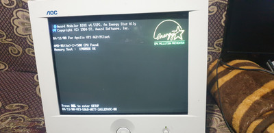

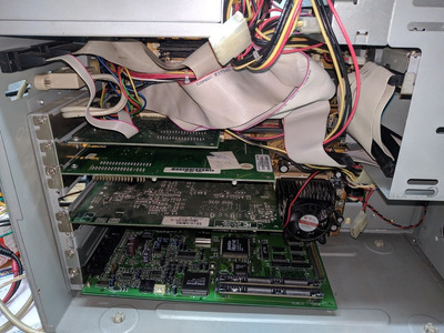

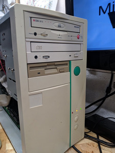

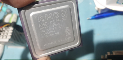

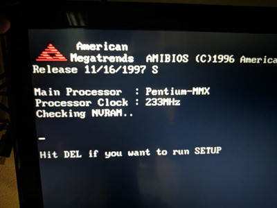

Started some work on my fresh EPoX EP-51MVP3E-M.
- added a K6-II+ 500MHz, 2.1V Vcore as it seems the board doesn't go lower (@Sphere478, you happen to know a lower voltage for this board?)
- 256MB RAM spanned across 2x64MB and a 128MB stick
- ESS Audiodrive 1869 😀
- Intel Pro100 LAN (funny innit)
- 3D Blaster Banshee CT6750 16MB
Currently workin' on a 98 reinstall. HDD came with a dead K6BV3+/66 that, despite fitting the EPoX like a glove, is in dire need of a refresh. I have all me aces up me sleeves.
Also dug out my AOC 7K+ CRT. Gotta love how well it runs.

What is typical is that all the jumpers off give 2.0 or maybe 1.8 some boards... if they're already off, then it's down to looking up the data sheet of the voltage regulator and seeing what you have to change the bias resistors to to take it lower.

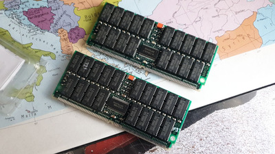

Hey guys
I have already asked this question in a separate thread, but since the range is greater here, I wanted to find out from all GA-586HX users whether these memory modules, each of which is 64 MB in size, work with my Rev 1.55.
They could be ECC buffered fpm modules.

ECC needs CPU support methinks, these must be for P Pro or early slot 1.

So absolutely no chance to use it in the GA-586HX board?

Chipset is supposed to support but seeing nothing on Gigabyte's side to say they fully implemented it. Think what I said before was just for those lines of CPU, when Intel started blocking things from working unless you bought the spendy crap instead of just letting it if the silicon was there anyway.

In that case I have no choice but to try it out. Are there even such large modules without ECC buffers? After all, the board can support up to 512 MB of RAM with a second TAG module
