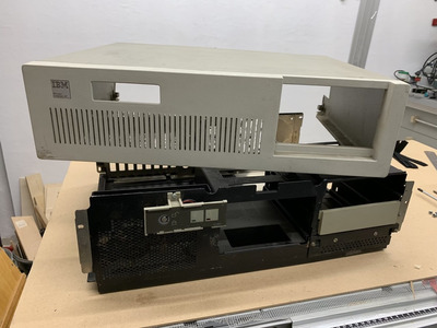

Just picked up a donor case for a rather tame DOS sleeper, P55C@233MHz. It’ll need some rust removal and touch up though…

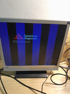

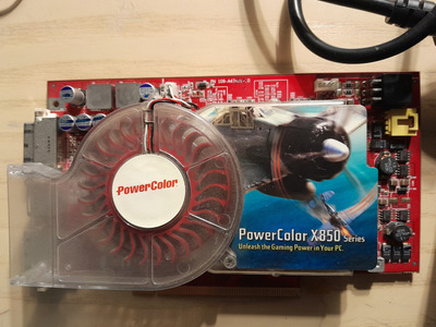

x850xtpe
"perfect conditions tested!!!!!!!!!!!!!!!!!!!!11111111111111111111111111oneoneoneoneoneoneoneoneoneone"
:roll eyes:

is that the one with dead in the image name ?
looks like a memory issue, might be temporarily fixable by reflowing the memory ICs.

yes. nomen omen.

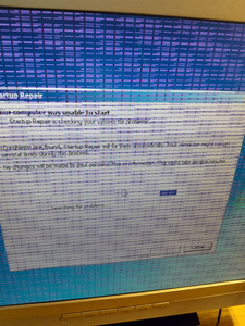

Here's another pic of the artifacts.

Give it a reflow with a hot air gun on the memory ICs, use Kapton tape around them if you have it so SMDs dont get heated up.
If this improves the artifacting then it might be worth reballing , I wouldnt normally suggest reballing but this is a X850 XT PE which is a special case card, if you cant do it you may be able to find a repair service that can do it.
I would personally send it off to Northwest Repair if I lived in the US, the guy is a repair god and might actually be willing to try his hand at it, he has done a few other retro GPUs before. (This card is worth the effort for me to do that)

I wouldn't guess that's a BGA issue.
I'd be firmly looking at RAM.
High res pics?

click on the image its pretty high res, its definitely ram, reflowing may help it may not at this point it cant hurt. I doubt itll last long even if it does help but itll give some indication if the ICs need replacing or not.

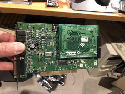

Diamond Monster MX300 (Vortex 2) with a Diamond Monster MIDI 4MB. Not sure how common they were back in the day but I think it’s funky companies were still making waveblasters in 1998.

Nice. I got one of those with a 2mb diamond midi card. Didn't know there was a 4mb. I thought it was only 512kb and 2mb

The 4MB version was included with the MX200.
