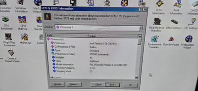

I had the motherboard/CPU clocked at 75mhz CPU bus and 4x multiplier (300 mhz CPU speed). I stress tested it for a couple hours when initially testing this setting, no issues whatsoever. I proceeded to use the system with these settings for a week, with no issues whatsoever.
I got concerned that the overclock may overstress the RAM, and changed BIOS settings to 66mhz CPU bus and 4.5x multiplier (297 mhz CPU speed). Upon rebooting, the system would not POST.

Reply 12 of 13, by YesAffinity
konc wrote on 2024-11-08, 14:07:
How are you setting all these different multipliers, is your Pentium II unlocked?
I assume so, 🤣. Setting them in the BIOS. It shows as 300mhz in Win98.
