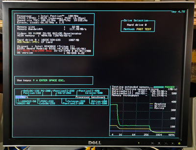

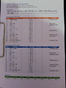

benchmarked 166mhz cpu

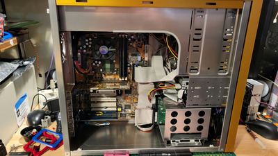

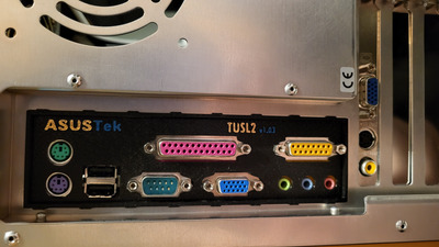

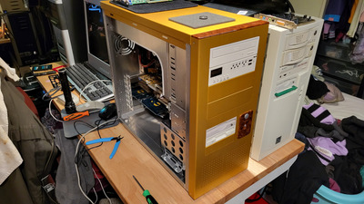

Today, I finished the TUSL2 build I've been working on. Does anyone know anything about this Gold/Orange Lian-Li? I'm guessing it was a pre-built from 2001? It had the sticker off the box of the Celeron that was in it (Now P3-1133). I was trying to find even a picture of one while on lunch, but no dice. Might look through old mags later, see if I can find one/it.
System Spec: (quickly, to quench curiosity)
ASUS TUSL2(1.03) Pentium III 1133, 2x256 Kingston ValuRam, ASUS MagicV8170 (GF420MX), NetGearFA-310TX

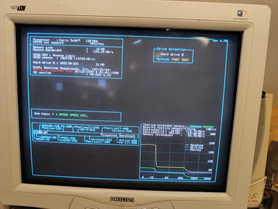

I had a little time to play around with my QDI V4P895GRN board and a Cyrix 5x86-100 cpu.
This gives me wie a nice 486 setup 😀Turns out my good ol' Cyrix still had it's power and runs all benchmarks just fine at 3x40 seeing and all ram at 0ws. Me happy 😀
Looking good! Also a nice monitor you have there, a true flatscreen as well!

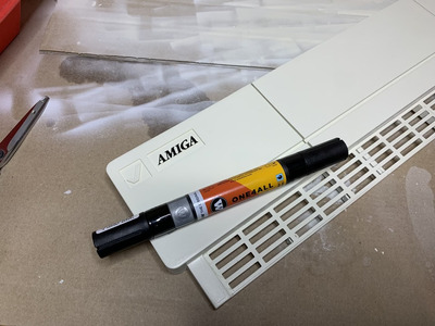

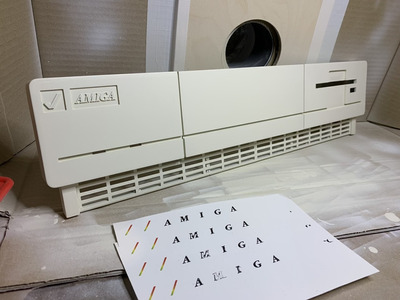

Been working on my A1000-lookalike bezel for the Checkmate 1500 case. It’s safe to scrap prototype 3.2 now as I have too many modifications to implement, reached a dead end, back to square one.
Nevertheless, to check the feasibility of following steps I painted the bezel with RAL 1013, which should be the correct color according to the website. It does match the metal case, that’s good enough for me. Printing to and using water slide decal paper (skullpaper®) did not work as expected, the color didn’t stick the paper and disintegrates on physical contact while placing the decals.
So I tried an acrylic pencil for the lettering, but that looks just plain wrong.
I ordered a different manufacturer’s paper from A now.
Are there any recommendations for known good products? What do you use for labeling drives, cases, etc…?
Try some coats of clearcoat lacquer over the top of the print on the decal paper.
The oldskool way of doing decals, was to get some of that dry adhesive paper that is moisten to activate adhesive, like stamps and envelopes used to be. Spray or brush 2 coats lacquer on that (adhesive side), let dry, paint or print onto that, then put 2 coats lacquer over it. Cut out decal close to outline, because there's the lacquer film on the blank bits.... then float that off in lukewarm water, sometimes having the tiniest spot of dish soap added would be helpful.
BitWrangler wrote on 2024-11-15, 15:24:Try some coats of clearcoat lacquer over the top of the print on the decal paper.
Thanks for the hint, I will try that next.
Make the badge spot empty and pay someone to do a high quality two-color FDM 3D print for you with very small nozzle size. Or have a nice one printed on foil paper or with a clear acrylic dome.

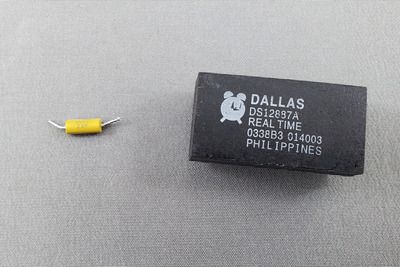

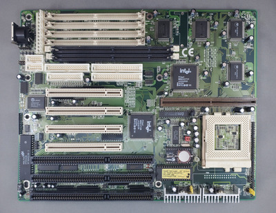

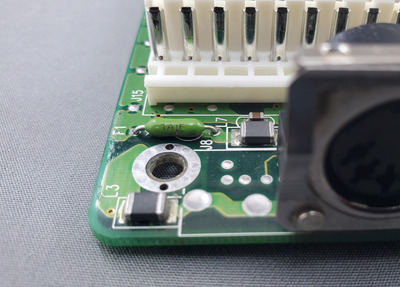

Repaired this Shuttle HOT-557 motherboard.
The board was reporting no keyboard connected, even with one plugged in. Measuring the +5V pin, it was only reading ~0.5V.
Culprit turned out to be the fuse, which had blown. In circuit, it was reading ~600 ohms, while out-of-circuit it was OL.
It also featured one of those lovely Dallas clock chips which needed to be swapped out as well.
Added a new 1A 125V fuse in place and everything seems to be working fine now.

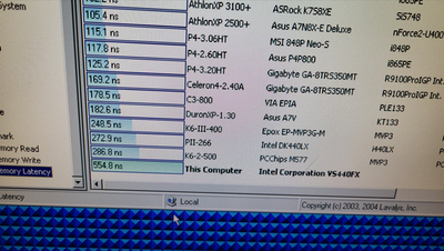

I worked a bit on my Pentium Pro build, and got a laugh out of this:
This was a record-breaker. 🤣

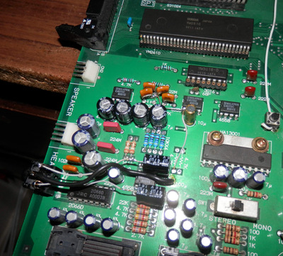

I added a proper line-out to my Neo Geo MV1 board, along with misc improvements such as better opamps to bring down THD and noisefloor and some changes in filter cutoffs. I even managed to find 4 matching opamps with 1990 date code to fit in with the other chips on the machine 🤣.
The speaker and headphone outputs of the device are quite noisy and sound very dirty (0.2% THD and higher by spec of the parts used) due to use of some bottom barrel parts and nobody going to hear anything in a noisy arcade room anyway 🤣. Now things are good enough with no perceptible noise floor and very nice and clean sound ~

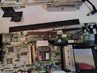

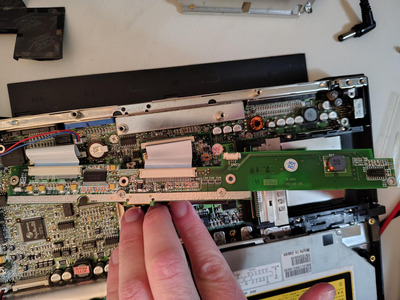

I took apart my Gateway Solo 2500 to fix the backlight. The palmrest has to be removed to access the inverter, and it's sandwiched between the base chassis and the hinges. To remove the palmrest, there are screws under the battery, floppy drive, and touchpad. Then you need to remove a metal cover over the inverter/LCD board (inverter, status LCD, main display connector, and power button), which is wedged under the CPU heatsink and card slot daughterboard. Next, you need to remove the entire board to remove the plastic insulator over the inverter, and the two screws near the middle are slightly too large for the holes in the PCB. After all of that, you need to reinstall all of the boards that you just removed (without the metal panels) to be able to power it up and start probing.
After all of that, it started working again. I could see that there was no switching activity on any of the transistors (PQ1 was the easiest to probe), and then I suddenly noticed that the LCD was lit up. Now I'm tracing the enable circuit, which appears to simply switch Vcc to the TL494 through some transistors (a PEMD12 dual PNP/NPN transistor at PU1) driven by an AND gate (next to the K7 marking, but it's probably U5 - the U is obscured by a via). One input to the AND gate goes to the video/card board, so I might also find out why the Xaos demo turns the backlight off until I reboot. The other input goes to a trace on an inner layer, but I eventually traced it to the second cable that goes to the motherboard. I can see that the input going to the video board is slightly below the high-level input voltage for the AND gate, but that's it.
I didn't find a schematic online (it appears to be a Quanta SQ2), and it would probably only be for the motherboard anyway. I would need schematics for three boards.
