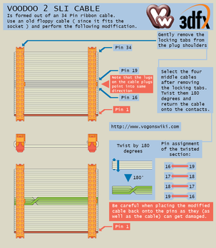

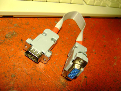

When I look at ebay the prices for cables of Voodoo cards are just crazy. For example the loop cable when you connect the VGA to 2 Voodoos and a standard 2D card. Is this really a special cable or can a standard VGA (male) to VGA (female) extension cable work too? Same for the SLI bridge cable. That looks like a very short IDE cable but it probably is not. Does it have a name so I can look for a cheaper version?

For the SLI you can get this one: https://www.serdashop.com/3DVideoBridge
It doesn't have the retro-vintage-rare!!!11! additional value factored in so it is priced reasonably.
For the loop cable, in order for the image quality to degrade the least possible, you need a high quality and short cable. Others will work but with a varying degree of effect on the final result. Not all people are equally sensitive to it though. I use a VGA splitter cable (with one connector hanging unconnected) because I wanted a short cable, others have chosen an extension cable.
Reply 2 of 5, by Postman5
The cable for connecting a 2D video card and Voodoo is a primitive 15-20 cm extension cable
