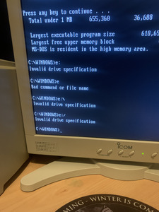

It's E: in my case as D is my second HDD. But I swear when I've typed E, it says Bad command or file name.

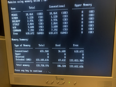

Reply 28 of 125, by DustyShinigami
Currently looking into getting the CD drive working in DOS. I’ve read I need to put my Oakcdrom.sys file from my boot disk into DOS’ folder, but I don’t know where that is. Where can that be found on Windows 98 SE?
I’ve added the necessary commands in the autoexec.bat and Config.sys files, too.
But as you can see, DOS does not recognise my CD drive at all…
The attachment IMG_3760.jpeg is no longer available

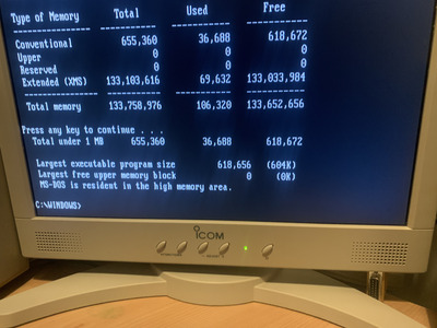

Also, here’s the results of MEM:
The attachment IMG_3758.jpeg is no longer available
The attachment IMG_3759.jpeg is no longer available

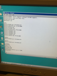

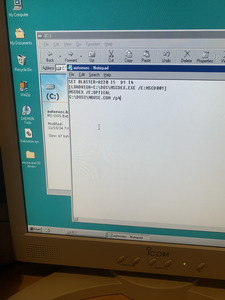

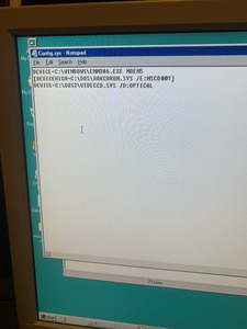

Still not working. It just doesn’t recognise the CD drive. 🙁 These are my autoexec.bat and config.sys files:
The attachment IMG_3764.jpeg is no longer available
The attachment IMG_3765.jpeg is no longer available
EDIT: Noticed I’d made a typo in the config.sys, and removed the old lines from yesterday’s experimenting, but no - still not recognised.

Reply 35 of 125, by Boohyaka
Do you have a floppy drive and would you be able to boot from the official DOS6.22 or Win98 bootdisk? Those have proper config.sys and autoexec.bat including CD-ROM initialization. So if your CD drive works with those, at least you'd know your hardware is fine and it's a matter of properly making your own config.sys and autoexec.bat.
Google "win98 bootdisk"
Reply 36 of 125, by sfryers
MSCDEX doesn't need you to tell it what drive letter your CD-ROM is going to use, it'll just take the next available letter that's not being used by your hard drives. Use MSCDEX /D:OPTICAL to specify the device name. The /E parameter has a different purpose- it tells MSCDEX to use expanded memory.

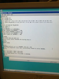

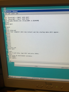

I have a Win98 SE boot disk, yeah. These are what the autoexec.bat and config.sys files say:
The attachment IMG_3766.jpeg is no longer available
The attachment IMG_3767.jpeg is no longer available
The attachment IMG_3768.jpeg is no longer available
What would I need to do exactly? Copy these into the files I’ve set up? And then modify them? Or install these devices in DOS using the boot disk?
