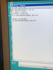

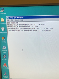

Well, initially, I got this working. I was able to run the tests and adjusted the volume whilst in DOS, but then after adding C:\SBPCI\SBINIT.COM to the autoexec.bat, I've had nothing but issues and now it won't load at all. 🙁 Everything I've tried just makes the bat file revert back and removes any command I put in. To begin with, SET SBPCI=C:\SBPCI was left in the autoexec every time I rebooted. Now that goes along with the command to make it initialise the SB PCI. If I add those commands back and then restart in DOS, it comes up with errors saying it's not able to detect or initialise SB PCI.

Reply 66 of 125, by sfryers
I'm not sure exactly what's altering your autoexec.bat file (probably something to do with the Windows 98 drivers), but if you add the SET BLASTER=A220 I5 D1 T4 , SET SBPCI=C:\SBPCI and SBINIT.COM lines back into autoexec.bat, then save the file, you can make it read-only by typing the following command at the DOS prompt: ATTRIB AUTOEXEC.BAT +R
This will prevent anything or anyone from altering the contents of the file. Next time you need to edit it again, you'll first need to unset the read-only status with ATTRIB AUTOEXEC.BAT -R
MT-32 Editor- a timbre editor and patch librarian for Roland MT-32 compatible devices: https://github.com/sfryers/MT32Editor

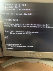

Reply 68 of 125, by DustyShinigami
sfryers wrote on 2024-11-17, 15:51:
Nope. Still keeps complaining the SBPCI environment variable not found. I really don’t understand why because when I tested it the first time this morning it was all working fine. 🙁

Reply 69 of 125, by sfryers
You could try putting the commands into a new batch file, maybe C:\SBPCI.BAT, and then running that after booting into DOS. I'm not exactly sure why it's complaining about the SBPCI environment variable not being set though, especially if it's in there twice!

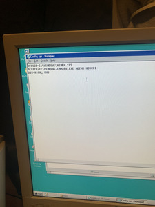

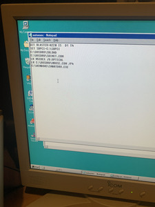

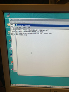

I might have to try that next. I’m totally at a loss as to what’s going on. If I use the autoexec.bat and config.sys files provided by the SBPCI drivers folder, the mouse and CD drives don’t work, but the audio device does. No errors, no issues. I even tested it out with Doom. EMM396 is configured to be disabled though. However, if I restart the PC, and re-enable the use of the CD drive and mouse, the two command lines for the audio devices are removed - the SET BLASTER and SET SBPCI - and the audio device stops working once it boots into DOS. Complains about the variables/environment again. D:
These are what they’re currently like, a hybrid of the provided files and what I’ve edited them to:

And this is the provided config.sys with the drivers, which disables EMM386:

Reply 72 of 125, by sfryers
I think the SBPCI environment variable is supposed to indicate the folder where the SBPCI driver files are stored, so if you have them in C:\DOSDRV, then the line in autoexec.bat should probably say SET SBPCI=C:\DOSDRV instead. I can't see anything else that looks incorrect.
Reply 73 of 125, by DustyShinigami
sfryers wrote on 2024-11-17, 18:34:
Yeah, just tried that now. Also, the complete command for SET BLASTER is different in the one provided. It should be SET BLASTER=A220 I5 D1 H5 P330 T6. I swear the last time I changed SET SBPCI to DOSDRV, the bloody thing set it back to the SBPCI folder again. >_>
EDIT: No errors! 😁 I’m sure the bloody thing will change again next time though, but at least that’s given me more of an idea how it should be set.
