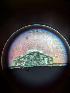

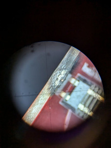

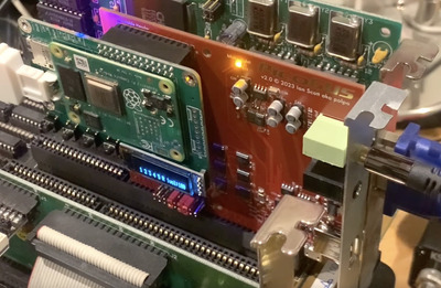

I had a bit of a scare recently with this card. I love it so much, and was really sad to see that something arced through it and sparked a small flame.
The attachment in-system.jpg is no longer available
I'm still trying to piece together how this could happen, but my partner looked at it under his scope and saw one of the traces was destroyed.
The attachment scope-1.jpg is no longer available
The attachment scope-2.jpg is no longer available
I was using this with the McCake Waveblaster attachment when it happened. Amusingly, the card's main functions continued to work (all hail the blinkenlight) but I'm probably not going to keep this connected in a system until we can investigate further.
I don't have skills adequate to build one of these myself, nor repair it. Not sure how to proceed.

did the mcake survive?, seems the logical thing is that is arced from it to the picogus.
maybe its too much for the pico to power a rpi compute module? I run a rpi zero 2 off the waveblaster and had no issues.

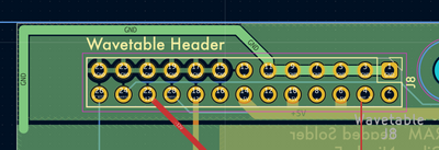

Yikes! It looks like the digital ground going to the WT header took a lot of current and burned out. This is the second time I've seen an issue with a really bad short with the PicoGUS and a McCake on the wavetable header. The first I saw happened when someone plugged their McCake in "upside down" which caused +12V to short to ground through the wavetable header. They had a modern 900W ATX power supply, and unlike oldschool PSUs, modern ones can provide an absolutely enormous amount of current on the +12V rail, so a short to ground can do just what you saw. So a couple questions: are you using a modern PSU? And how did you have the McCake mounted? It should be like this as shown in root42's video on the PicoGUS:
The attachment picogus-mccake.jpg is no longer available
I've reached out to Serge from Serdaco to see if he has any ideas for how this could happen and how things are connected on the McCake side of the wavetable header. This is how things are on the PicoGUS side:
The attachment picogus-wtheader.png is no longer available
I am using a Sparkle branded 300W PSU, it's old enough to have an AT power connector on it and has honestly done a better job at keeping systems older than Pentium 4 stable than modern PSUs.
I have indeed connected the McCake as indicated also - with the 4-pin power toward the front of the case and the front-panel connector toward the rear bracket.

Thinking a bit more, it might not be a large amount of current on that digital ground (GND) trace itself but arcing between it and analog ground (AGND), which is right along side it on that layer. So something to check: in any normal circumstance, GND and AGND will be at the same potential. GND and AGND are tied together by a 0-ohm resistor or ferrite bead marked FB3 on the board next to the DAC chip (in old builds it's a ferrite bead, in new ones a 0-ohm resistor but in either case it'll have continuity). Does that component have continuity on a multimeter? If there was a large potential between GND and AGND, that resistor almost certainly would have popped before the arcing happened, so if there's no continuity that would point to that situation.
Now how could there be a large potential between GND and AGND? Just thinking out loud for possibilities: the ground of your audio equipment is somehow offset from normal ground, or something weird happened on the McCake, or something else I can't think of happened.
If FB3 has continuity, that points more towards there being a short between one of the voltage rails and digital ground on the McCake somehow.
Reply 1231 of 1707, by SaxxonPike
polpo wrote on 2024-11-24, 05:55:

Is it possible that that ground trace is simply routed too close to the cut edge and a 5/12v line on another layer and the cutting process caused enough disruption to both traces to create a time bomb?
It does look like it's right on the edge.

I never looked at picogus PCB. That layout needs some love. Route analog/digital signals over solid ground instead of kludges like physically separate analog/digital grounds - that stuff doesnt work in real life. Afaik this practice hails from the times of 2 layer boards and relying on hunches and bad intuition. Here from companies that knows what they are talking about
https://resources.pcb.cadence.com/blog/2021-s … l-ground-planes
https://resources.altium.com/p/how-to-use-a-s … ound-connection
Signals will always use shortest path for ground return EDIT because I wasnt clear: shortest from the track sending the signal, and paradoxically for UART_TX its going right to analog ground thru the fuse and then to rp2040. Left audio channel going over islands of no ground between pins 15-22 🙁 Same for Uart TX going over broken ground.
