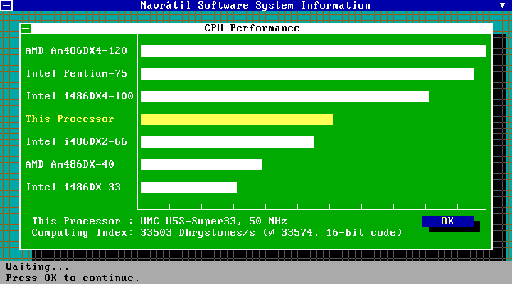

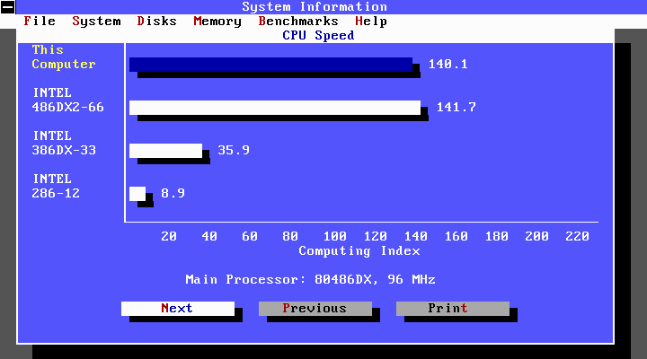

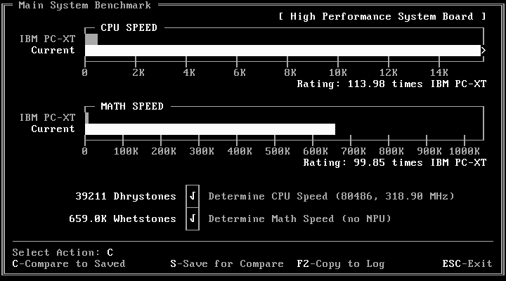

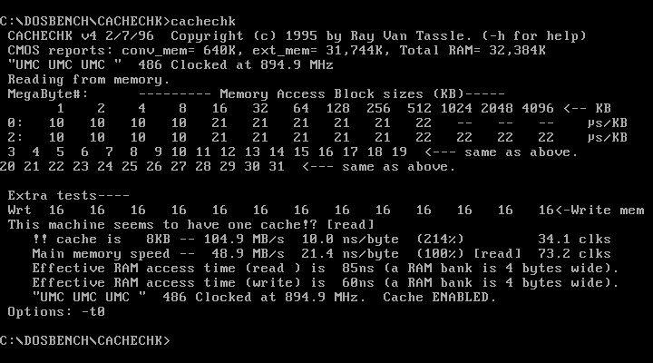

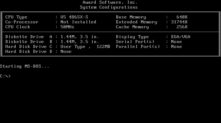

As promised some actual screenshots from the thest with the U5 @ 50 MHz...
PS: Notice how this U5 completely screws the CPU speed detection algorithm of CACHECHK. I wonder what kind of code really runs nearly 18x faster than on an actual 486 50MHz... 😀 Maybe it's just the internal timer that cannot keep up.
    7.71 KiB
    673 views
    4.04 KiB
    673 views
    7.74 KiB
    673 views
Reply 27 of 63, by rasz_pl
MSxyz wrote on 2024-11-23, 08:20:
900MHz, impressive 😁

Reply 30 of 63, by MSxyz
rasz_pl wrote on 2024-11-23, 09:44:
On air, without even a heatsink!
Who needs 3nm CPUs? 😁

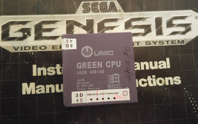

Reply 31 of 63, by BitWrangler
By pure coincidence, though I guess U5 was on my mind due to this thread, mine turned up, was looking for a spare Dallas to have modded ready to deploy, then saw stray CPU at bottom of a box, dead bug mode, "Not for US sale" emblazoned on the bottom and the penny dropped, THAT'S MY U5SX!!!!!1111oneone.
Sadly got some pins to straighten as a result of it's adventures outside the CPU holding pens, but looks like it will be alright. My eyes must have slid over it in the past thinking it was just another i486SX or something boring.
I have a circa '92 ISA board on the testbench at the moment, will see if it works on that and give it a spin, might not like it since it's 2 years older than the CPU.
    512.72 KiB
    554 views
    UMC U5SX 486-33, 9446k date code.
