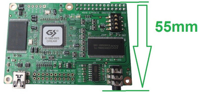

JustJulião wrote on 2024-03-03, 11:05:

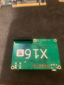

As someone asked but got no reply: does it fit physically an Audician32 card (height from ISA bus)?
Yes, the pcb dimensions are : 53mm (height) x 77mm (width)
It is mounted in 'landscape', the needed height in isa slot direction must be larger than 55mm :

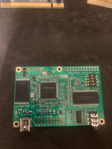

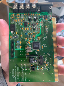

Reply 44 of 57, by fNzpyk

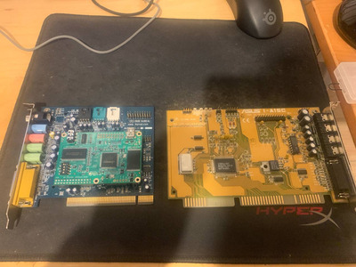

Hello friends. I need help. My Dreamblaster X16GS perfectly work by USB on Windows 11. But not worked on ASUS I-A16C (Vibra 16c) and Aureal Vortex 2 SQ2500. Under DOS and Vibra, i use unisound. Under Win98 and Vortex 2 i unmuted MPU401, but still dont have sound from Dreamblaster. Under Windows 11 and USB, dreamblaster use all two led indicator red and green. On my soundcard under dos and windows, only red led is lighting. Help my if you can, thanks.

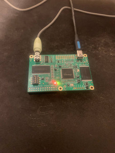

sorry, i can't writing in messenge, because my account is new. I attaches photo, it's work fine, sounds good, green led is beping.

update: Dreamblaster X16GS perfectly work on Crystal CS4232-KQ. Very easy to install and use. No one problem.

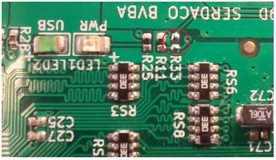

Matze has kindly borrowed me his SB16 CT2230 card, so I could investigate the incompatibility that some people experienced with X16GS.
I found the cause and a solution for this, and will share the details below :
1.89 MiB
1013 views

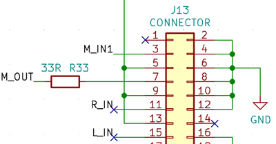

The problem seemed to happen when pin 7 from the SB16 is connected to pin 7 on the X16.
It seems some sound cards such as CT2230 pull this pin high at bootup.
The Dream CPU detects this pin status during bootup, and as a result , uses the wrong memory configuration, and the bootloader doesnt start.
This is the cause of the incompatibility.
24.76 KiB
1013 views
X16/X16GS had pin 7 connected for possible future use (sending midi data back to the interface), but this has remained unused, as no soundcards support this. So pin 7 has no useful function.
The solution is to disconnect pin 7 on the X16/X16GS. This can be done simply by removing R33. Alternatively, the trace between R33 and pin 7 can be cut.
See the images below for illustration of both modification options.

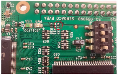

X16GS before modification:
173.96 KiB
1013 views
X16GS with R33 removed:
137.15 KiB
1013 views

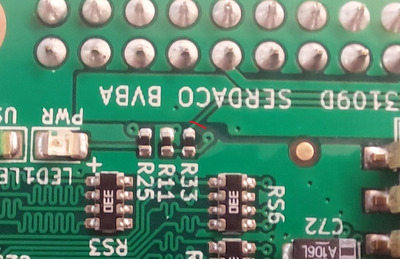

X16GS with indication where to cut trace (alternative solution):
117.86 KiB
1013 views
From now on, I will be shipping X16GS and X16 with this modification.
So making this change is only needed if you have an incompatible soundcard,
and an X16/X16GS ordered before August 25th 2024.
Thanks for your support !

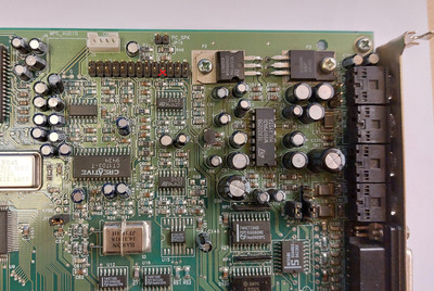

A further alternative, if you are not comfortable with removing an SMT resistor or cutting a trace, would be
to cut off one pin (marked with red cross) on the waveblaster header of your soundcard :
614.46 KiB
957 views

In X16, I have midi out from the dream chip connected to this pin, for future use. (no real use for gaming purposes anyway)
This midi out pin on the dream chip is shared with memory config detection function during boot. (I have a 10k pull down on this pin, so normally it is at state 0 at boot)
see extract from Dream SAM5716B datasheet :
22.02 KiB
932 views
It was only when I tested with the SB16 CT2230, that I realized this side effect can happen.
If your soundcard has this pin pulled high at boot time, it may be needed to make the mod to ensure compatibility.
Luckily it is an easy adjustment.
From now on, I will ship all X16 and X16GS with the R33 resistor removed, which completely solves this.
