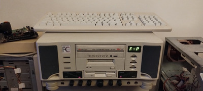

Hello, I thought this might be just the right place to ask what graphics card would make the most sense in my dream 1997 build.
Here are the specs so far:
Gigabyte GA-586HX Rev 2.01
64 MB RAM
S3 Vision 968 ?
3dfx Voodoo 1
Aureal Vortex 1
Creative CT1920 Gold Finch addon card
Media Vision PAS16 w/ SCSI header
Dual Nakamichi SCSI CD changers (5 CDs, 16x speed)
Now there are three restrictions for the graphics card:
-must be from 1997
-must be PCI since board doesn't have AGP
-cannot be longer than the 3dfx Voodoo because the CD changers get in the way.
Ideally I wanted to pair this with an S3 Virge GX2, but to my knowledge this card is AGP only, and even if I use another motherboard with AGP slot, it's also too long.a¹
Another thought was an ATI Rage Pro PCI with 4+4 MB memory for CIF, but that ATI cards, line Matrox, unfortunately break compatibility with some DOS games like Commander Keen and Jazz Jackrabbit. That's not a total dealbreaker though, as I still have a real 486 for these purposes.
What would you do?
