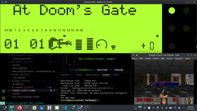

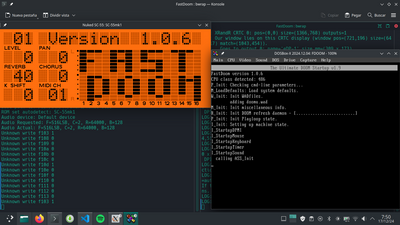

Reply 1165 of 1201, by ViTi95
Soooo a new release for #DOScember, changelog (1.0.6):
- MIDI SysEx support (MPU401, LPT MIDI, RS232 MIDI and Sound Blaster MIDI)
- Roland MT-32 support (via -mt32 command line parameter)
- Roland SC-55 support (via -sc55 command line parameter)
- Show song titles on MT-32 and SC-55 devices
https://github.com/viti95/FastDoom/releases/tag/1.0.6

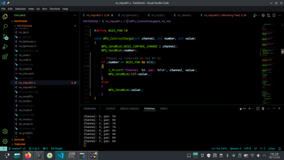

Reply 1173 of 1201, by ViTi95
Yep I'm using MTGM.MID from Roland, is not perfect but better than nothing.
184.06 KiB
1062 views
MPU_ControlChange
I'm not an expert in MIDI stuff, may be this the solution to the panpot problem @auron?

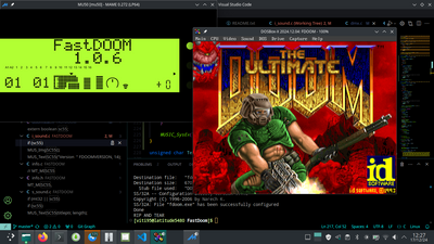

BTW next release will also have Yamaha XG support
290.48 KiB
1062 views
Yamaha MU50 - FastDoom - 1
396.97 KiB
1062 views
Yamaha MU50 - FastDoom - 2
