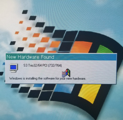

Yeah, so here's a fun one, it's basically what it says on the tin. Just did an installation of Windows 98 SE on my new CF card on my Pentium PC, and... There are 193 copies of my S3 Trio VGA card in the Device Manager.
The attachment 20241221_052920.jpg is no longer available
Video... Seems to be working fine? I mean I have an image obviously, and I able to run Dungeon Keeper without a hitch (just the Win98 game that I had on hand), so I don't know if it's actually causing any problems, but it seems like A Problem, even if I'm not encountering any effects of it just yet.
Anyone ever seen this, have an idea of what it might be or how to fix it?

Reply 10 of 29, by PlunderBunny
Uh-oh...
The attachment 20241222_114630.jpg is no longer available
Like I was worrying, Windows sees about 200 new graphics cards when I reboot after removing them all.
-_-
Still holding out hope someone will have a suggestion for a more permanent solution... Or at the very least maybe some kind of explanation as to why this would happen.
EDIT: Just to note, it once again installed exactly 193 copies of the card, with only one flagged as working (obviously), same as before. So whatever the bug is, it appears to be CONSISTENT, which is something.

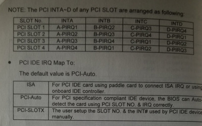

Alright, I'm trying to mess with... What I think are all of the BIOS Plug & Play settings, as far as I can tell. However, I haven't had any luck with it, I'm hoping someone can help me look at this and figure out how it actually even WORKS, because the BIOS settings and documentation feel needlessly arcane to me.
So, based on the manual for my motherboard...
The attachment 20241223_142116.jpg is no longer available
The attachment 20241223_142201.jpg is no longer available
This is my understanding of how it works:
This BIOS page should be how I can manage Plug & Play vs. manual configuration for PCI devices. Each slot seems to be able to be set to A, B, C, D or AUTO, with AUTO being automatic Plug & Play configuration of the IRQ. The 4 actual IRQs that the system will use for each of the slots is configurable using the 1st/2nd/3rd/4th Available IRQ settings.
The way you actually manually map a slot to an IRQ is by assigning the A/B/C/D settings to each slot, which in turn has a specific per-slot IRQ mapping relative to each slot and the Available IRQ settings that have been assigned, and these ABCD-to-PCISlot mappings are shown in the table on the second image. This motherboard comes with a PCI slot IDE controller card that I'm using, and that's what the "PCI IDE IRQ Map to" settings correspond to: you either leave it on PCI-Auto to let the BIOS configure it automatically, or select a slot manually, or use the ISA setting if you have an ISA card you're using for IDE control. The "Primary/Secondary IDE INT#" settings are where you assign the A/B/C/D settings to determine the IRQ for each of the two IDE connections on the card.
I THINK that's how it all works, that's the only thing I can figure out, someone please correct me if I'm wrong. Moving on, using that understanding of things I tried to assign my IDE controller to slot 1 rather than auto (elsewhere in the manual it implies that that's the only slot it can function in, but that's neither here nor there), and then leave the Primary/Secondary to the default D/A, so consulting the table that means available IRQs 4&1, which map to IRQs 12 and 10 by default.
Then, because my graphics card is in slot 3, I try to assign it to setting D, which would correspond to Available IRQ 2, which maps to IRQ11. This way, everything should be on different IRQs and there should be no conflicts.
However, when I do that, nothing changes and Windows still finds all the duplicate cards.
Thoughts? Am I misunderstanding how this works? I've disabled everything I could find relating to ACPI in the BIOS, and nothing else seems related to Plug & Play
