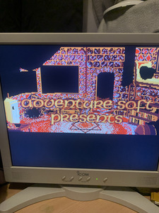

And as a separate issue - has anyone encountered this with the Win95/98 version of Simon? And found a way to resolve it? I remember getting this back on my first Windows 98 PC, and I think I remember trying to set the colour depth to 256 colours, but that hasn't worked this time, and setting the background to black. Unfortunately, I can't set it to black; just the default blue.
The attachment IMG_3778.JPG is no longer available
Sometimes it sticks around during the credits as well, but once that all finishes, it goes back to normal

I've discovered a workaround for this issue. If I disable DirectDraw or Direct3D in the DirectX Diagnostics Tool, it cures the problem! 😁
