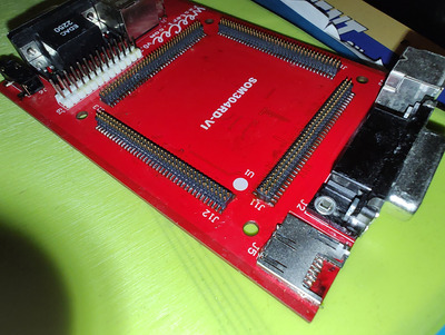

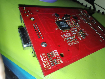

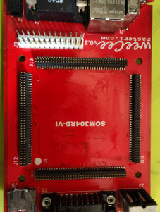

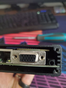

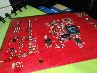

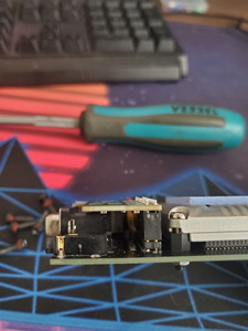

Reply 948 of 996, by ErroneousHyphen
snipe3687 wrote on 2024-10-24, 12:15:
ErroneousHyphen wrote on 2024-10-24, 04:17:
Ive definitely done something wrong somewhere, just not sure what now.
can you send some updated pictures of everything? it's probably something minor somewhere. it always is! at least in my case 😉
Here you go, Ive tried to get good angles on it as best as I can. I can give close ups on particular areas if it might help identify whats up

Reply 949 of 996, by snipe3687
From the pictures everything looks ok. I’m wondering, can you check all the vga pins for continuity to ground? The first time I tried buildings one of these I somehow bridged some of the traces and grounded out the vga which would prevented it from showing picture. I’ve built about 4 of these now so worst case scenario I could send you a working board if you pay shipping. That way you can at least test against yours.
The only other thing I can think of is to try to clean some of the flux off the bottom and see if that helps. Probably won’t do much but couldn’t hurt.
The vga connection is a straight shot to the SOM so there’s not even any passives that could be mis-soldered.
The only pins that should go to ground on VGA are 5-8 and 10 and then 5v on 9 only. Give that a look and let me know!
Reply 950 of 996, by ErroneousHyphen
snipe3687 wrote on 2024-10-24, 22:15:
From the pictures everything looks ok. I’m wondering, can you check all the vga pins for continuity to ground? The first time I […]
Grounds have come up fine
pin 9 is getting 4.6v (powered by USB port on a power board plugged into the wall)
Reply 952 of 996, by ErroneousHyphen
snipe3687 wrote on 2024-10-25, 02:16:
That’s good! Do you happen to have an oscilloscope? If so, check the RGB lines and see if there’s any signal on them when powered on. Should be pins 1-3
I dont have an oscilloscope unfortunately no 🙁

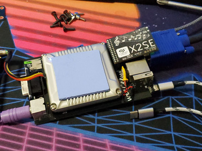

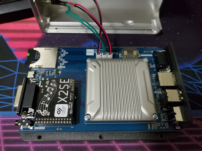

Reply 953 of 996, by Emerson Wagner
Mu0n wrote on 2023-11-30, 01:49:
Emerson Wagner wrote on 2023-11-29, 23:05:
Have you ever figured out any way to disable S2 without pulling it out? There are sometimes rare situations when I wish I could use it instead.
Short of adding a mechanical switch on top of cut traces, I don't see how personally. So I haven't.
So I found some solution to disable midi module... kind of. Hear me out 😀
Due to my issues with random keystrokes in the weecee I purchased, that I described here, I gave up on it. I purchased other similar project, pixelx86 and I got the X2GS SE for it from Serdashop. That module has 2 banks for soundfonts, one is Roland licensed sc55 preset, the other is user bank that can be flashed with custom soundpack. You can switch between those banks with simple command from dosprompt. So I simply flashed user bank with blank file. So when I want to use external device through midi port, I switch to user bank and let my Rolands play, while midi module thinks it's playing but it's silent. It's stupid, but it works as intended.
The problem is, pixel has enough space for x2 module, while weecee does not.
But to stay ontopic, I actually fit it in weecee, little angled, to test it. And it works. I just can't slide it back into case.
So I know it's not really a solution for weecee, but some it is some kind of possible avenue I guess. A module of the size of s2, that could switch to "silent" set of intruments?
    208.71 KiB
    790 views
    206.75 KiB
    790 views

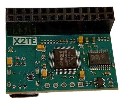

would a GS version of X2TE (X2 tiny edition) be a solution ?
it is only 35mm x 25mm in size , see https://www.serdashop.com/X2TE
if interested, send me a PM
61.9 KiB
766 views
Thanks for your support !

dreamblaster wrote on 2024-12-24, 09:43:
61.9 KiB
766 views
I think it would! As long as it comes with bank select option to switch instrument packs quickly from prompt. It's only 1mm longer than S2 on each edge, and S2 is a perfect weecee fit. I'm not sure about the thickness as it would come with usb port I assume. There's little space below (weecee's vga port internals) and above (flat case).

Reply 958 of 996, by dreamblaster
Emerson Wagner wrote on 2024-12-24, 17:27:
61.9 KiB
766 views
I also have a special edition X2TU, without USB connector, which i can pre-program.
this should sure fit. - you could try either X2TE or X2TU -> send me a pm !
