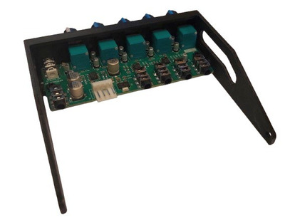

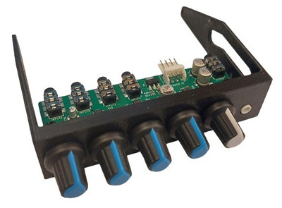

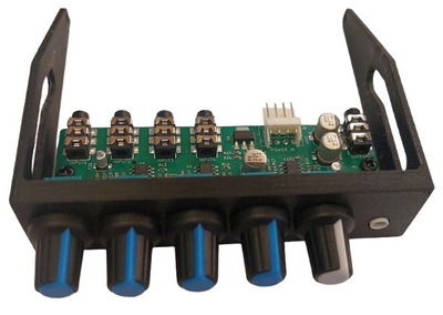

I made some first working prototypes of a new project : MixerBay
This is an audio mixer for the 3.5" drive bay
Feel free to suggest improvements, and maybe also a better name
rear side :
  • 4 x line in (3.5mm stereo connectors)
  • 1 x line out (3.5mm stereo connector)
  • 1 x floppy power connector
front panel :
  • 4 x potentiometer for controlling input levels (1-4)
  • 1 x potentiometer for controlling output level
  • 1 x headphone out (3.5mm stereo connector)

Reply 2 of 40, by Joseph_Joestar
dreamblaster wrote on 2024-12-30, 09:58:
This looks great! I'm just wondering, would it be possible to make an adapter which converts the standard IDE CD audio cable to 3.5mm input? Or maybe add the CD_IN pins as an alternative input on the mixer?
I wager a lot of people would prefer to have CD audio mixed in separately, so that it can only be used when needed (due to noise).

Reply 5 of 40, by Yoghoo
If I understand correctly you have to wire the cable (for most sound cards) externally back inside the case to use it? As most sound cards (at least the ones I have) don't have an internal 3.5mm connector. In my case only one wave table card has an internal 3.5mm connector. If so it's a bit too messy for my taste to be honest but I'm sure that a lot of users with multiple sound cards in one retro pc will love it. Hope there will be a 8 port external version in the future. 😜

Reply 8 of 40, by appiah4
My immediate suggestion would be to replace the 3.5mm internal jacks with 4-pin headers instead.

awesome 😀 i dont think you can really improve on it, as for the inputs i think you should stick with 3.5 jacks over the 4pin headers others have suggested, i think the easier option would be to make up a cable, it will only require soldering a few wires from an old cd cable onto a 3.5 jack, i have an old external cd drive which has the same cable but goes to RCA's,
the 3.5 jack is more multifunctional since a lot of wavetable boards/midi devices use either a jack or RCA's it will be easier to connect up, but with 4pin headers people will have to make up a bunch of cables just to use the mixer
a 5.25 version would be good though since most cases only have one 3.5bay, and most will be using either a floppy/gotek or card reader, i was thinking a larger 3/4 jack on the front for instruments would be good, though i could just make up a cable.

Reply 11 of 40, by psychofox
appiah4 wrote on 2024-12-30, 11:27:
Yep, it was quite hassle to create correct lenght cables for 3.5mm jacks. On the other hand i would not tottally replace 3.5 jacks but there should be both options on mixer board (some sound cards have no 4pin headers on board).
Also it would be nice if you could create passive mixer, at least i think this cheap aliexpress mixer unit picks up some noise there.
I would add an Line-in port to front panel next to headphones .
Most cases have only 2 3.5" bays, so i would suggest to create also an "high end" 5.25" version of mixer, maybe with eq and led graphic equalizer.

I would appreciate an option for flat pot-knobs because I have one of those PC cases with a door.
Reply 13 of 40, by elszgensa
Pretty much my first though. Either that, or at least include the necessary footprints and offer a version with the jacks kept unpopulated.
Definitely gotta have a beige panel as an option. Or some other lighter color, something that's easily painted over.
Speaking of panels, you currently have a single mounting hole per side. Have you tried this design in a variety of cases yet? Maybe others need the screws in slightly different locations.
Optional ones:
- A choice in knobs might be nice, I don't like the ones pictured. Might imply a need for different pots with different length stems? Actually, come to think of it - probably easier to scratch my earlier "partially populated" idea and just offer all-loose-parts DIY kits for people wanting customization.
- Quick mute button
- LEDs (one per channel, with changing brightness) or some other way to easily see where signals are coming in, even when turned down. Basically el-cheapo VU meters. (If this gets picked up, please use the good old dim red/yellow ones though, not the modern bright blue "floodlight" type.)
- Maybe also offer a 5.25'' panel. With the same board behind it. Just in case all 3.5'' bays are taken.

Are your mixer solution based on an NE5532 preamp ? I heard they are quality stuff from high end system that are today's outdated so they provide cheap solution for great result and come aplenty as NOS. I cannot see on your pictures what chips you are using. I am using one of those on a similar solution I eventually came up with, your build is of course way better put together but I feel they might be similar under the hood.
If you check out my thread (mainly at the end) you can see that I struggled about providing input for the PC Beeper, it somehow fried the AC/DC rectifier, but I dont even understand what use case scenario would benefit an AC 10~17v power source. Into one computer case of course you use the DC 12v. With a 100ohm resistor and 1μF at least no more electronic fire and melting wire sheath, but the Beeper sound is way too strong and noisy. Maybe I should increase the resistor or start my own thread about it 😅 Oh well, I'm just here to ask if you considered it since you request improvement suggestion. (The Psychofox VU meter is soooo neat, I'm clearly jealous !). I think it make sense to add in the mix the pc beeper as some older games would put sound effects there and music on an FM or PSG chip. Being very crude you might want to tone it down, just think of the magnificent Xacalite speech in the Silpheed intro which sounded so bad that nobody noticed it was broken before a while 🤣
Reply 15 of 40, by Tiido
NE5532 and other "proper" audio opamps are not really usable at 5V supply rail (although 12V can be ok), they aren't having Rail to Rail Input/Output and clip far too early with limited supply voltage. They are meant to operate at +/15V or 30V, and on PC you only get the negative rail from ISA/PCI/PCIE slot, or AT(X) connector. But with a molex or floppy you'll be stuck with 12V and need a a DC-DC converter to go beyond. (virtual grounds are of course a thing and will help but they typically require far more parts than if you had a negative rail available to use).
