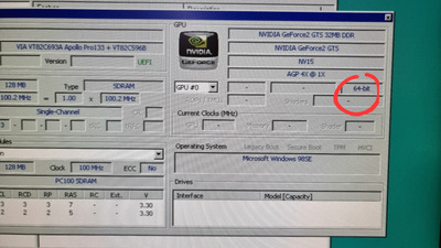

Reply 26 of 105, by RetroPCCupboard
SPBHM wrote on 2025-01-01, 14:06:
GF2 GTS 64bit?
I've never heard of such a thing before, is it a damaged card or something?
I hadn't heard of it before either. But that's what HWINFO is telling me:

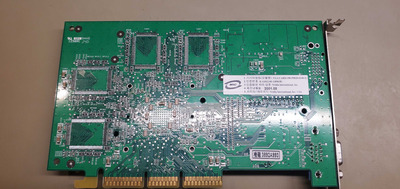

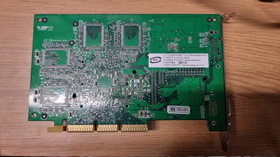

The unpopulated memory pads on the back are a clue I think that it's not 128 bit.

Reply 27 of 105, by RetroPCCupboard
GF2 GTS 64bit?

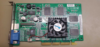

Here's someone selling the same card but the memory chips on the back are populated:
https://www.ebay.co.uk/itm/131479681541
I wonder if mine can be turned into a 128-bit card just by adding the memory chips?
Also I Notice that on this motherboard the card was only running at AGP 1.x. I wonder if nVidia drivers detect a VIA AGP slot and slow the GPU to improve stability.

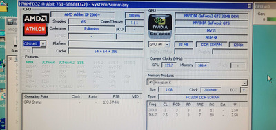

I have that exact same card and its identified as 128 bit and does not have memory ships on the back.
352.77 KiB
569 views
I also have 2 other of the same card that has memory chips front and back, they all have the DS/N CN sticker on the front if not mistaken is found on most Dell cards of that time.

You definitely got scammed on that card. GTS's were never 64-bit. I think you're dealing with an MX 32MB that someone force flashed to a GTS.

Im not sure what version of HWInfo you are using but it looks different then the one I just tried 5.72
1014.18 KiB
521 views
917.58 KiB
521 views
880.52 KiB
521 views

Maybe also double check with Everest Home Edition 2.20 (freeware).
It would be highly unusual to have a 64-bit GeForce 2 GTS, but I wouldn't put it past some OEMs.
