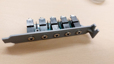

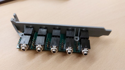

Reply 33 of 39, by dreamblaster
Bracket prototype ready, it seems to fit.
Comments?

Reply 34 of 39, by DudeFace
dreamblaster wrote on 2025-01-30, 20:50:
Bracket prototype ready, it seems to fit. Comments? […]
Comments?
91.49 KiB
532 views
91.58 KiB
532 views
cool design 😀 good option for those that dont have a spare bay, even has the 4pin headers, this will please a lot of people!
i was thinking about the bay version, i like things to be symmetrical having the knobs off centre would niggle me on an OCD level. 🤣, but you'd have to remove or relocate the front jack to compensate, then i was thinking most people not using onboard audio, but using a sound card wont be making use of the front panel audio, if you could add an AC97 header instead people will be able to make use of thier front headphone/mic jacks which otherwise would go un-used.
Reply 35 of 39, by appiah4
Comments?
91.49 KiB
532 views
91.58 KiB
532 views
Oh yes, I can see this being very useful!

Reply 37 of 39, by Jinxter
91.58 KiB
532 views
What if you added one volum knob (with a press function) on the bracket. And added electronics that controlled the volume trough pressing in the volume knob.
No press = master volume
1 press = output no 1 volume
1 more press = output for no 2 volume.
and so on.
I totally agree that a front panel is way cooler, but this would make a very cheap solution, and you would not need a available bay.
But i guess all electronics would have to be moved to the bracket.

Reply 38 of 39, by KVM Nerd
Nice project!
Comments?
91.49 KiB
532 views
91.58 KiB
532 views
Hmm, what about connecting the bay to the bracket with a more reliable connector? Maybe Dupont, which would work with standard CD-ROM drive audio cables, or a single multi audio channel connector to connect all audio channels at once? The LiveDrive had a single ribbon cable for example iirc.
Jacks are not very reliable in my experience, especially the 3,5 mm and smaller types, often introducing contact problems. In the current implementation, you would have four jack connectors in series from the sound card to the bay (including the sound card itself), and another three on the way back out of the case, with seven connections in total.
