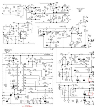

So, I need advice on a problem with an old Fortron/FSP ATX-350PNF power supply. I think I bought the PSU in question after the mid 2000's when Athlon XP/64 and P4 CPUs were still in use. The PSU is with passive power factor correction.
The power supply works in principle and I'm currently using it for testing systems with processors for socket A, socket 370, slot1, socket 7 and older, but its line voltages +5 and +12 V have become quite "off". I've adjusted these power lines as far as possible through the common for +5 and +12 V lines adjusting trimmer VR1 (I'm attaching a circuit diagram for FSP ATX-350PNR model, because for 350PNF I couldn't find, but the only difference is missing PFC reactor for the PNF model), which is located on the separate small PCB with the PWM regulator chip, and now these voltages are almost at the tolerance limits (the +5 V line gives about 4.75 V no load, and the +12 V line about 12.65 V).
After the long stay in the closet, the power supply had two leaked electrolytic capacitors on the "stand by" +5 V and one filter cap on the output line +12 V, but I've replaced them with suitable analogues, generally nothing fatal. But the problem with the voltages turned out not to be due to dried up or leaked electrolytic capacitors.
And now the question:
How do I get the +5 and +12 V output line voltages as close as possible to their nominal 5 and 12 V values?
I haven't touched the VR2 trimmer, which is on the main PCB, because I have no idea how it will affect the +12 V, possibly the +3,3 V (this voltage at least is stable - about 3,35 V and not affected by VR1 on the small PWM PCB) and +5 V voltages.
As another option to solve the problem, I think of replacing the power resistors R41 or/and R42 on the main PCB with different values, but I have no idea what power they dissipate, and they are of the larger cylindrical ones. - Ok, thanks to Horun I realized that this is not going to work.
I suppose, if I replace some SMD resistors on the small PCB with the PWM chip, it could also affect the output voltages, but I'm not with electronics as a first speciality and when there are semiconductors in chips and microcontrollers involved the things get totally messed up for me 😁 According to the schematic, is there any easier option in fiddling with resistor values replacement? - Nope, there's no way.
To solve the PSU's output voltages problem I am ready to accept and try any advice from a person with real practical experience in electronic circuitry. Thanks in advance!

Reply 1 of 44, by Horun
You testing the volts with out a load ? You should always put a few amps load on the 12v and 5v...I use a few old scsi HVD drives for that purpose, they draw lots...
R41 and R42 are minimal load resistors, do not change those.

Reply 7 of 44, by mkarcher
analog_programmer wrote on 2025-01-05, 19:40:
and also removing 1-2 windings from the +12 V winding with the increased output voltage. I did all of this, but for my PSU it did not give any noticeable result with improvement in the output voltage values in the problematic +5 and +12 V lines.
I guess you are talking about L1 in the schematic. This inductor is meant to reduce cross-regulation issues, and does not affect 5V-to-12V that much if both rails are loaded "similarly". So I guess you can have one of two issues:
  1. You are loading the supply in a way that cross-regulation compensation is required, i.e. at your load on +5V and +12v, L1 is supposed to push some energy from +5V into +12V. If the core of L1 failed and the coil does not transfer energy as expected anymore, this could explain your issue.
  2. L1 is working fine, but the transformer outputs (from T1, the main transformer) are bad. The basic ratio between +5V and +12V is set by the turns ratio in T1. That ratio does not change by component aging, but you might need to check whether all rectifier diodes are still working OK.

Reply 10 of 44, by Horun
Agree should check the diodes. Also do you have a oscilloscope ?
Am wondering what the ripple on the +5v line is compared to the +12v line under small load, might help pinpoint something.
In a pinch can use a good digi voltmeter on ac (depending the dvm, some do not read well above a few hundred hertz)

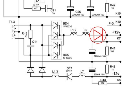

Reply 12 of 44, by analog_programmer
I see that here I'll not be able to find some electronic's way to reduce +12 V line output voltage slightly under 12 V, so both problematic +5 and +12 V lines voltage values can be adjusted close to their nominal values by VR1. Ok, let's try the electrician's way 😀
Maybe not the smartest idea, but what if I add some 35+ A power diode on the +12 V line after the scre*ed-up output inductor? Its V-drop will reduce the output voltage by 0.6-0.7 V, which will be enough for my case:
62.81 KiB
607 views
The problem here is, that I can't find any not so bulky power diode for more than 35 A current. The label on the PSU "says": +12V1 = 18.0 A; +12V2 = 16.0 A. Any suggestions for a suitable less bulky diode?

Reply 13 of 44, by Horun
That is a good idea. My thought on diodes is for BD3 sbl2045 schottkys, as they age their voltage drop (Vf) can raise, listed at 0.5v @10A, which could account for a lower +5v output. Noted the 12v are sfa1603G of 1.0v Vf @10A..just thinking aloud...
Reply 14 of 44, by analog_programmer
Horun, now I've figured out the idea with the power double diodes measurements. It really makes sense if the V-drop of the double diode BD3 on the +5 V line has increased over time. On the other hand, there is no reason for the voltage on the +12 V line to increase with time due to similar aging effects for BD4 and BD5.
Of course I can dismantle the heatsink and measure V-drop for the BD3 diodes, just to be sure if they have some deviation from the nominal value. But If I replace BD3 with brand new substitute and still +12 V line stays about 12.5 V at +5 V line set to 5 V, this will not help me much in general.
I was hoping to find some electronic's way to adjust +12 V line voltage below 12 V, so I can use VR1 to set both +5 and +12 V lines to more acceptable values.

Reply 15 of 44, by Horun
analog_programmer wrote on 2025-01-08, 17:22:
Your idea of simple high current diode is probably the easiest. You could use 2 lower amperage in parallel to get higher max Amps.
Something like two of these 25A max types (with Vf of .7 @1A, .8v @10A and axial leads): https://www.digikey.com/en/products/detail/di … P2500A/22191581
You could try first no load and then small load and try to set the +5v near 5.1v and see what the 12v looks like....hopefully near 12.0-12.1v
Reply 16 of 44, by analog_programmer
Horun wrote on 2025-01-08, 18:04:
Actually I was also thinking of two or three smaller diodes in parallel, but maybe I should pick them from a pile of diodes, so that their parameters are nearly equal - I don't want to get an overload by current on one of them.
Thanks for approving my simple electrician's idea and for your suggestion for diodes I may use. As long as there are no suggestions for changing the original circuit's components, I think I'll just take "the path of least resistance" i.e. the easiest way to fix the problem even if it's a quick and dirty fix 😀

Reply 17 of 44, by analog_programmer
I can't find any similar in size and current rate of 25 A (or more) like these P2500A at my nearest local electronic parts shop, but I found FX2000A rated at 20 A/50 V (Vf < 0.82 V at 5 A, < 0.94 V at 20 A, max Tj = 150 degree C, axial leads) for about EUR 1 each piece. 40 A for two in parallel, I think they'll do the job. What do you think?

Reply 18 of 44, by Horun
Yes think those should work well.
Reply 19 of 44, by analog_programmer
Horun wrote on 2025-01-08, 21:12:
Great! My last concern is their operating temperature and cooling, since I can't attach any heatsinks to them and they will only be cooled by the airflow from the PSU's fan. On the other hand these diodes will not actually work in rectifying mode. I just don't have an idea what amount of heat they will produce in that case.
