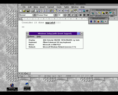

Reply 11 of 62, by JSO
I was using Windows 3.x (switched to 3.11 FWG late 1994) since October of 1992, until 1999 when I upgraded my dad's PC (i386Dx). With the vga default driver.
I only saw higher resolutions and color depths when I created a DOS / Windows 3.x vintage build in spring of 2004. Celeron 300A, Voodoo 3 and found that Voodoo 3 had Windows 3.x drivers!!! I was excited seeing 1024x768 on Windows 3.x!
DOS IS THE POWER OF OUR CHILDHOOD MEMORIES!
Reply 12 of 62, by appiah4
Post screenshots or it didn't happen..

Reply 15 of 62, by JSO
appiah4 wrote on 2025-01-06, 11:06:
Take it!!!
