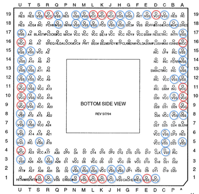

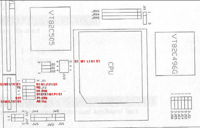

Tried to figure out why Pentium OverDrive CPU didn't work at Jetway J-437 motherboard.
With the installed CPU 5V rail is shorted to the ground, to check this I decided to find any pins in socket that connected to the ground and what pins are connected to the power rail.
Some of the Vcc pins definitely sorted to the ground so I decided to remove any jumpers and continue to measure the shorts without them. You can see the tracing result on the picture. The blue circle mean that pin connected to the Ground and the red one means that pin is connected to the Voltage regulator.
Then I tried to trace the jumpers PINs and found that documentation didn't fit the jumpers on the motherboard. With all this new information I thought that I found the cause of the issue, but not, the shorts still exist with the any of the jumpers configuration. Seems that it would be better to create a separate thread.

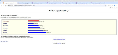

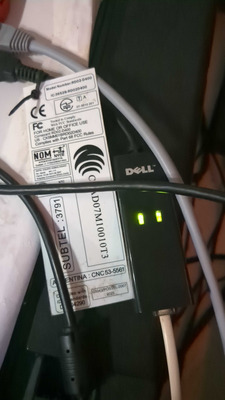

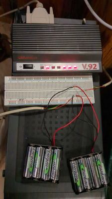

Browsing this forum at 33Kb/s using my DIY dial-up internet server. In fact every time this year so far I've used a dial-up connection to browse and post on Vogons (IDK but it feels right to do it like this). Can't wait to get a PABX so that all my retro PCs can dial into each other.
The attachment IMG_20241229_181504_745.jpg is no longer available
The attachment IMG_20241229_181604_451.jpg is no longer available
The attachment Screenshot_20250112_215735.jpg is no longer available

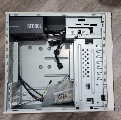

I have an issue with my Pentium III 933Mhz / Geforce 2 GTS build in that I want it in a SFF PC case but my BeQuiet 450W SFX PSU fails to power the board. But a full ATX PSU does fine. So, I have bitten the bullet and bought a much more expensive PSU that supports 20A on the 5V rail.
The attachment 20250113_140930.jpg is no longer available
Seems wrong to spend more on the PSU than I did on the other parts.... but, have to say, this PSU feels so high quality compared to the 450W BeQuiet one.
Next issue though is that I wasn't paying attention to the specs and didn't notice that the ATX power is 24 pin rather than 20+4 pin, and also it doesn't have a berg connector for floppy drive/gotek. So, I have had to order adapters.

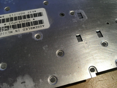

These '90s laptops have nice big keyboard frames that use plastic stakes (sometimes screws) to hold in the membrane to the keyboard's backplate.
I pulled the keyboard apart, this time using the soldering iron at 200C on each of these pegs so that they could deform without breaking, for later use.

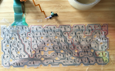

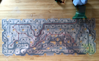

Took apart the keyboard and started following the traces on both sides but doing it just by eye is more work than it's worth. I taped it to the desk to get it flat then took a picture of both sides and drew a layer over the top with lines to visualise it. Nothing wrong with the bottom side:
The attachment keyboard-repair-underside.jpg is no longer available
The topside is much more complex to follow - notice those little black traces connecting each pad, each one is about a 10k resistor. Following it, the discolouration was visible from my picture, one of the top traces at the upper edge of the keyboard has discoloured and the connection has gone from 20 ohms to 60k ohms:
The attachment keyboard-repair-topside.jpg is no longer available

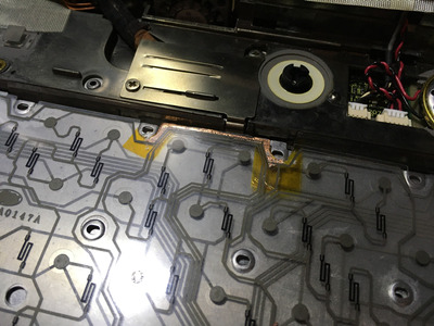

I tried using the conductive paint again, but it didn't do much good. I found a better way this time - the self adhesive copper tape is sticky on one side and conductive on the other. Stick the conductive tape over the part that needs replacing and a few mm longer, fold over the ends so the conductive side is touching the membrane trace at each end. That bridges the connection and provides a trace that's held in place, but maybe a fresh conductive ink pen would be better.
The attachment IMG_11589.jpg is no longer available
Then put Kapton / polyamide tape over the top which keeps it connected. Then I put some extra Kapton tape over the copper just in case it could short on anything.
The attachment IMG_11579.jpg is no longer available

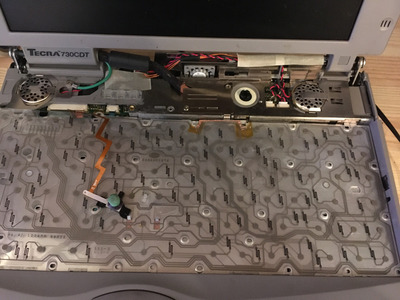

Tested it one last time and the up key now works, no random key presses so it's all melted back together, again using the soldering iron to press on them but with a bigger round tip to squish it nicely:
The attachment IMG_11599.jpg is no longer available
Yay! now the Tecra 730CDT is back to 100% working. I've got quite a full set now - Tecra 730CDT, Tecra 740CDT and Tecra 750CDT 😁

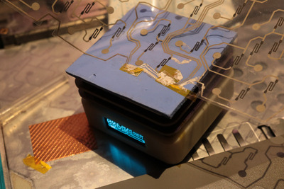

*sigh* The other day I found that the repair I did on my Toshiba Tecra 730CDT was not working. The keys that are broken are quite important so I had to take the keyboard apart again, using the soldering iron to undo all the heat stakes so I could check out what was wrong.
In hindsight, the repair I did here may not have been the fault, I think, because there was a break further up the line where corrosion damage eventually killed some more of the trace. Quite possible the conductive adhesive for the copper wasn't making good enough contact any more. Conductive paint is much better but harder to apply.
I pulled off my copper tape repair which resulted in ripping the membrane on the edge. 🙁 So I had to clean off and re-route three keyboard traces through the smaller area.
The attachment IMG_5093 (Custom).JPG is no longer available
At least now I've learned some very efficient methods for doing keyboard membrane trace repair. Now I use the cheap silver conductive paint that you get from china in a syringe, but to apply it I take off the needle part and use a rubber thermal paste spreader nozzle thing as a brush to get a nice even coat. To lay down the new traces I use some cheap polyimide tape (which has poor adhesion) as masking tape to get the lines, then paint on the new trace.
This conductive paint has to be heat cured though, so I use my USB-PD hotplate with a thermal pad on top to bring it up to 100c and that then starts conducting and I can then check for crossover with other traces, scraping off paint where that occurs.
This method works really well, having the thermal pad and hotplate keep the membrane in place makes it easier to work on.
