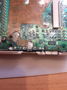

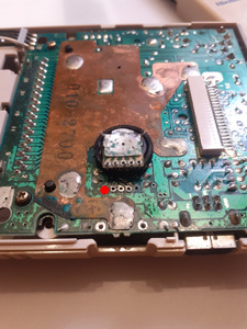

Hello,
Recently I got a gameboy Dmg.The screen had lines but I managed to fix that.The volume pot was battery corroded,so the pcb pins of it.The question is,what the first left pin is about?I tried to find where it goes but it is connected only on an empty pcb spot(no copper)I am uploading and a photo(the red hole it that).
Thanks in advance.

Could be that a via connects a solder joint on the bottom to the ground plane on the top, and the alkaline may have damaged the via. Should probably make sure with a schematic around VR1.
