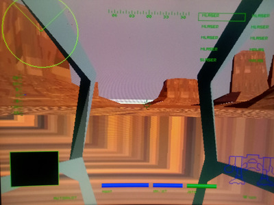

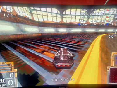

I decided to test POD and MechWarrior 2 anyways, the former works decently well, I think, and the latter has some texture issues. Due to constraints, I only have phone camera shots only.
There are more games in Windows, I believe, that supports S3D. Croc should be one of them. Descent 2 is DOS only if I am not wrong, and so is Fatal Racing?

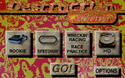

The wrapper uses the same video mode as the game, so 16 bits. Strange colors means pixels are being rendered with the wrong bit masks. They seem to vary from one video card to another, although the wrapper makes an attempt to figure out the correct one on launch. Maybe the auto detection is failing and the default isn't good for such and such card.
