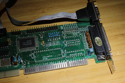

I’ve purchased one of these cards, one of the members here has advised me that I might be able to get a BIOS chip from one of our members, to make it possible for me to be able to get large hard disk supports. Anyone able to point me in the right direction?

So the card is actually a QDI COMPUTER, INC. QD6500A
http://www.uncreativelabs.de/th99/c/P-R/20752.htm
It's just that there's a traverse through the board on the Q that makes it look like an O.
I stumbled into one recently and I'm going to try to make it work with XTIDE

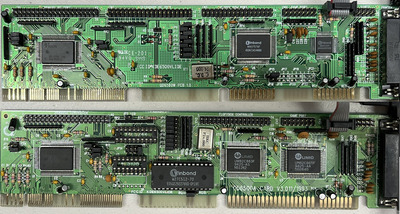

I can't get the rom to work. Both of these cards work with 32bit Xtide UB when I put the rom in a Lan Card, but I can't get the rom slot in the QD6500A to work yet.
The Rom slot is labeled "27C512". l tried a W27C512-70 and a AT28C64. Do I just have the wrong roms?
871.79 KiB
1452 views
Top card has a QD-6580. Bottom card has a QD-6500 + rom socket and two extra sockets labeled 74LS244 & 74LS138 .
Should I consider adding a 74LS244 buffer chip? They look like they are pretty inexpensive.
Also, what is the 74LS138 chip for?
Reply 15 of 29, by Thermalwrong
They are probably both necessary. On this card that doesn't have any parts populated yet, the ROM address jumpers ranging form C800 to DE00 connect into the 74LS138, which I think is for decoding the address access / determining where it maps to. The 74LS244 probably connects the ROM segment of that card to the ISA BUS.
Reply 16 of 29, by douglar
Ok, that makes sense for the 74LS138. I’ll try it again once my chip arrive.
Could the 74LS244 chip be a fifo buffer of some sort? J16 on my board is to enable it.
Edit: I'm not an expert on this, but seems like it's a bus driver: https://www.ti.com/product/SN74LS244#description
That would be for send signals across the ISA bus, yes?
