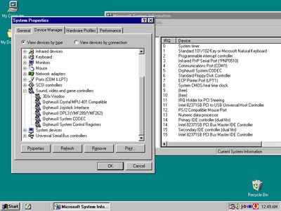

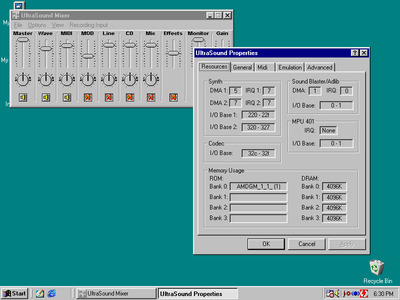

Hey everyone! Just got my hands on the Orpheus II and began my journey to get it working on my pc.
The system is IBM PC 330 type 6577
it has a Pentium 200Mhz MMX CPU, 80+smth (4*16 sticks plus extra special IBM stick) RAM
Voodoo PCI GPU
details are here(haven't updated yet)
also i added the 16mb fpm memory stick to the Orpheus.
my main OS is Windows 98 SE, so i began by installing the drivers there.

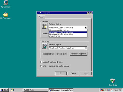

Unfortunately, my first experience was the terrible screeching sound on windows startup, see for yourself: https://youtube.com/shorts/uRxD3AKY3hA?si=vhj6_v6T9nG6d2Y_
This is what device manager show me:
53.89 KiB
1164 views
i checked the sound output devices, and this sound distortion is happening when the "Ultrasound CODEC Wave Driver" is selected as an output:
53.01 KiB
1164 views
when i choose the Ultrasound SYNTH, the sound seems OK
but when i choose the CS4236 the sound loops (for example, when i move the windows volume slider, the sound repeats itself about 20 times)

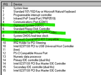

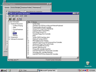

well, as the most obvious place to start, i dived into the IRQ headache.
as it happens, the IRQ 5 is occupied by LPT1 port:
80.84 KiB
1164 views
Which is very weird, because i disabled the LPT, COM and infrared in BIOS. Ok, let's go to the BIOS. Indeed, they are all disabled
474.02 KiB
1164 views
but it's obvious now that they still occupy their IRQs. Only thing i can do is change the IRQ for LPT, and the only options are 5 or 7 - and both of them needed for crystal chip and GUS on the Orpheus.
when i change the LPT IRQ to 7, Crystal chip began functioning properly , but there's no more GUS in devices:
88 KiB
1164 views
So i suppose there's no way to truly disable these ports on my machine in order to free the required for the Orpheus IRQs, which makes me very sad(
Maybe there's some workarounds you can point me to?
Or the only option is to change the PC to something more versatile?
Reply 1162 of 1261, by keropi
Do things work OK under DOS?
On the first attempt everything is a mess, Crystal is on IRQ9 for example which will never work correctly as PCMIDI's default IRQ is also 2/9 - this does not look like a fresh win98 installation right? It will probably worth to re-install with the orpheusII already present in the system
You might also need to manually assign IRQs after installation - windows might pick weird values so a little juggling could be needed

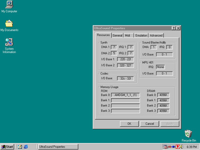

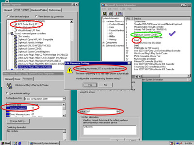

Tried the fresh install. Seems that it didn't help, but i've managed to free both 5 and 7 IRQ by disabling the LPT port in Device Manager. Then i've manually set the Crystal chip to IRQ5, and the sound from crystal is now functioning properly as it seems.
Unfortunately, i cant set the IRQ for GUS to 7. Here's how it looks right now:
170.46 KiB
1081 views
So what we have here is that the crystal chip works and gravis is now identified by windows, but behaves weird - the screeching sound of CODEC output is still present, and when i choose SYNTH is clicks when i change the volume in windows volume cotrol, otherwise sounds normal. Haven't tested any games yet though.
BTW, until i installed the Orpheus crystal drivers, windows installed its own drivers, and in sysinfo there was a MPU401 device at IRQ9, but it had an exclamation mark. Now the IRQ9 is free for some reason.
Reply 1164 of 1261, by keropi

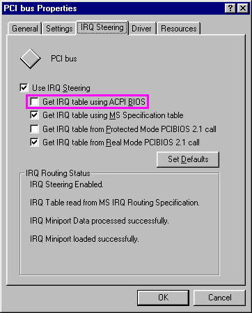

I believe it is still doable to get good resource management - you might have to go to BIOS to enable/disable PnP OS and maybe mess with PCI IRQs - if any of these options are available...
You should have a ROLAND MPU401 device at IRQ9/port330 , and Crystal MPU should be at port300
also point #11 from the OrpheusII site might be applicable :
11. Under win9x I cannot allocate the resources I want for GUS PnP and/or CS4237 even though I reserved resources in BIOS
This could happen on an ACPI system and all you could manually allocate are resources that are less than ideal for ISA soundcards.
The solution to the issue is to disable the "Get IRQ table using ACPI BIOS" option. Instructions to find the option follow:
- Open "Device Manager" navigate to "System Components" and select "PCI-Bus".
- In properties of the PCI-Bus deactivate option "Get IRQ table using ACPI BIOS" (untick the box).
- Click "OK" and restart your computer - hopefuly on next reboot you will be able to allocate the desired resources.

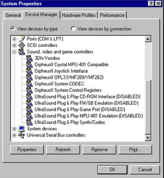

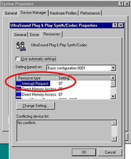

Reply 1165 of 1261, by priangle
keropi wrote on 2024-12-28, 14:03:
Forgot about it after the quick install 😀
Don't know if it helped, but I managed to set the correct IRQ for GUS by selecting different "Basic Configuration":
32.53 KiB
1028 views
Then I opened the "OrpheusII Crystal MPU-401 Compatible" device settings and discovered that there was no IRQ assigned to it in "Basic Configuration 0000", switched to Conf. :0001: and it's now on IRQ9:
24.53 KiB
1028 views
Question is - should it be on IRQ9, or it must be IRQ2? Also it seems that the port for "Conf. 0001" is 300, not 330.
anyway, it seems I managed to get all the devices at their correct IRQs:
62.77 KiB
1028 views
Despite the seemingly correct IRQs, I keep having the abovementioned problems (clicking noises on the GUS "Synth", and a pure noise on "CODEC").
Here's a short clip demonstrating the issue.
I suspect the incorrect settings on MPU-401 (the jumpers on OII is at default position)

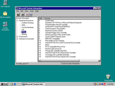

Reply 1168 of 1261, by priangle
keropi wrote on 2024-12-29, 20:53:
yeah it seems there is still some conflict, perhaps something is on the IW Codec address? What interwave address you are using? 240? try something like 260 and see what happens
the Crystal MPU does not need any IRQ even if it reports one , make it use port300
PCMIDI is jumpered on port330 and IRQ2/9 and I do not see it being detected on your list (probably because of conflict with Crystal MPU) so you need to do a manual hardware scan and it will come up as a Roland MPU-401 interface
Thank you!!! Fixing a problem a day 😀
I've detected the proper MPU-401 device and it got itself IRQ9, so that's fixed:
75.65 KiB
863 views
