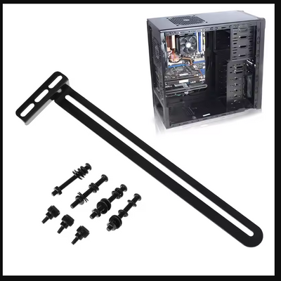

The case only has provisions for one fan at the front with the psu fan acting as exhaust, and I'm not sure where to fit one near the 7 expansion cards the system contains , but I'll look into coming up with some sort of solution.
You can try a side-mounted fan bracket. I'm using one of those in my Voodoo 3 build (see pic).
These are available on eBay, Amazon and other places. Just search for PCI fan bracket.

Joseph_Joestar wrote on 2025-01-18, 20:18:
AppleSauce wrote on 2025-01-18, 20:05:
I found this one on aliexpress , is it the same one?
Thanks for the suggestion btw , this solution might be the way to go.

AppleSauce wrote on 2025-01-19, 12:56:
Yup, looks just like mine.
