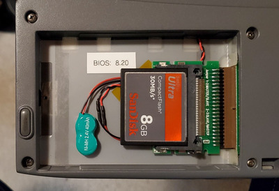

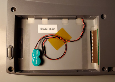

Reply 24 of 53, by Kahenraz
You can also hide the battery in the HDD bay if it's easily accessible. Here is that's I did on a Toshiba laptop where the battery was normally buried deep inside the case.
The battery cells are held in place with double-sided tape.

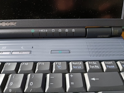

Reply 34 of 53, by megatron-uk
I think I have just witnessed a failure of one of these power boards in real time.
Because with the power supply connected and the mains power switched on.....
384.38 KiB
378 views
... it is now completely dead again. Not even the mains standby indicator illuminated.
If this is indeed the case, then I'm not sure I can recommend the use of the VAIO F-xxx series models to anyone if the power board can fail as spontaneously as this - I had about 8 hours of use on this machine since restoring it and putting the replacement power board in. This has got to be conclusive evidence that it is not directly related to battery leakage; there was virtually no corrosion at all on this replacement board.
Wow. That has been quite a journey to get to this point. What a damn shame - it had the potential to be a great DOS/W98 gaming device. I can't justify trying to acquire yet more - possibly broken - power control boards.
https://www.target-earth.net
