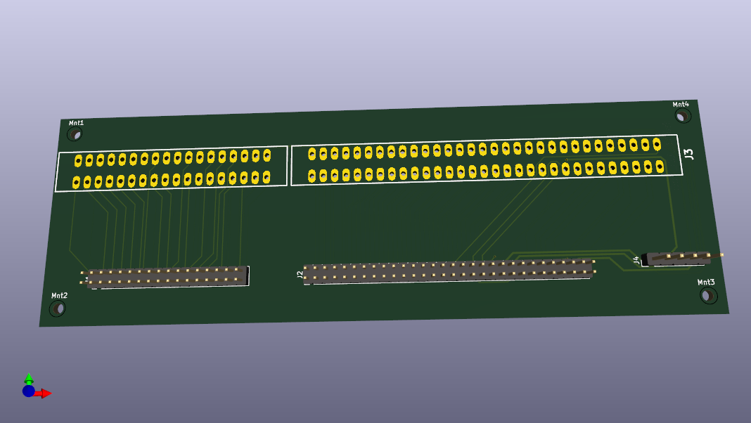

Reply 420 of 543, by Inhibit
BitWrangler wrote on 2024-12-05, 04:36:
Are we intended to connect that with extension ribbons?
It's got the same 2.0 pin pitch headers as the Pocket 386. A directly pinned breakout. I assume the ISA8 ribbon plus an additional ribbon will work but I'll need to check the pins orientation on everything.
Reply 421 of 543, by BitWrangler
I thought ribbons, because otherwise I wasn't sure how the power header was going to have room to not hit anything when you were trying to plug it to the interface. Then I am a bit suspicious of how much leverage the weight of the ISA card would apply to the pins on the P386 if it fits like that.
edit: unless the render screwed up by not representing right angle IDC pins and the ISA slot sits on the face of the board toward us, so the whole thing sits flat when plugged and the ISA is upright.
Reply 422 of 543, by Inhibit
BitWrangler wrote on 2024-12-05, 15:13:
... it never occurred to me to just use a 90 degree female edge connector going directly to the Pocket 386 for a plug-in daughter board. That might be a better design if fiddly to create.
I'd just have to get the spacing spot-on and make a 3D printed housing that adds the depth necessary to make the whole thing flush. And measure the edge on a ISA card back-shield to see if that'd give enough space for the overhang. Though I suppose you could always hang it off a table or we could tray the whole laptop.
I'm sure for commercial users 1mm pitch cable is a standard 1000ft roll 3M part number but for a few meters on the secondary market it's pricey. Finally settled on two 30 pin ribbons to make some additional ribbon cables if necessary and fired off the connectors order.
Anyway! Simple design for now, old-school expansion tray for later!

Inhibit wrote on 2024-12-05, 04:28:
And I finally had a few minutes to sit down and re-familiarize myself with KiCad. And thankfully find all the footprint librarie […]
And I finally had a few minutes to sit down and re-familiarize myself with KiCad. And thankfully find all the footprint libraries I needed.
Click for Mk1 ISA Breakout Image
Things to add:
  • SMD spots or through-hole fuse holders for the external voltage lines
  • optional diodes to make external supplied voltage card-only
  • thicker traces to the external power
  • external power header that isn't 2.54 pins
Any other suggestions while I'm working on it are welcome!
This looks awesome! It would be a huge stretch goal far beyond the scope of a simple 16-bit ISA breakout board, but I'd eventually love to see something like a "Pocket386 Dock" which connects all the back connectors of the device to a breakout box with an ISA slot + the 2 PS/2 ports, VGA, and Serial.
Reply 426 of 543, by Inhibit
EriolGaurhoth wrote on 2025-01-23, 16:15:
Thanks! So... I did actually get a (likely) working board soldered together after a revision to compensate for a quirk in my KiCAD workflow and a flip to the hastily added edge connector. Only I realized I don't *have* any ISA-16 boards handy; I need to borrow a couple over the weekend. If it's all working I'll put up some pictures!
Ah... one other thing about this is that it's a royal pain to actually build with the parts BOM I had to use, requiring some manual sanding of the connectors to fit them. I might need some one-off connectors manufactured for that oddball number of 2mm pins. I couldn't find a good source of (acceptably cheap) 90 degree 2mm double pins in that long of a strip to do an edge connection with. Suggestions are welcome, naturally!
Honestly? Doing a full breakout tray probably isn't that much more of a pain. If I recall those pins only required connections. I was planning on carting this up in a 3D printed case anway to float it the correct distance from the table with the edge connectors I ended up designing it with stuck in.

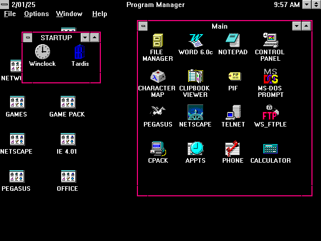

I've yet to find the cojones to dissect/desolder the R38 but I did find this to reset date/clock automatically in WFWG as long as you're on-line. A caveat: the default time server is long-gone, so I used utcnet.colorado.edu and time will tell, so to speak.
in WFWG Startup, Tardis finds your internet connection (Femto or serial-to-wifi), adjusts date/time, then a simple Enter, Alt-F4 makes everything current.

@myne If WFWG uses ndis and DOS uses MTCP, etc to get on-line, would a DOS net time stay persistent once WFGW loaded?
Reply 430 of 543, by myne
All net time does is update the Rtc.
I don't see why not, but I was thinking more along the lines of a login script.
