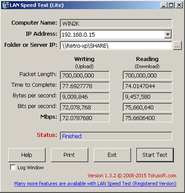

Here are my Lan Speed Test results on Win2K:
57.67 KiB
1048 views
This is slightly faster than what I get when copying an ultra compressed 7-Zip archive, but close enough I suppose. Curiously, I can't get these speeds under WinME, which I'm dual booting on the same PC. Under Win2K, I get a steady 8.1 MB/s when copying files over the network, while under WinME the speed varies between 4-7 MB/s. Maybe the network stack is worse under Win9x or something.

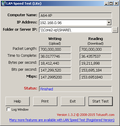

I tried something interesting today: FireWire networking. How? Easy, I have a couple of retro rigs with Audigy cards, which of course have a FireWire port on the back. I connected two of them together using a 6-pin FireWire 400 cable and set up their IP addresses manually. It worked fine, and the computers were able to see each other on the network. On my Celeron 600 system, I was getting transfer speeds between 6-12 MB/s under WinME. Meaning, I experienced similar speed fluctuations as with the 3Com card, likely due to the Win9x network stack. Unfortunately, I couldn't test this under Windows 2000, as that OS doesn't appear to support FireWire networking out of the box, at least from what I've seen.
However, I did manage to network my Athlon 64 3400+ rig with my Core 2 Duo E8600 system using FireWire. They also use Audigy cards, but have WinXP as the secondary OS. Under WinXP, FireWire networking worked fine, and gave me a steady transfer speed of 18 MB/s (no fluctuations).
9.76 KiB
686 views
This was mostly for fun, I just wanted to see how FireWire networking works. I'm guessing faster transfer speeds are off the table because Audigy cards are using the PCI bus, or maybe it's something with my setup. In any case, this is a fun alternative to regular network cards, though not very practical.
