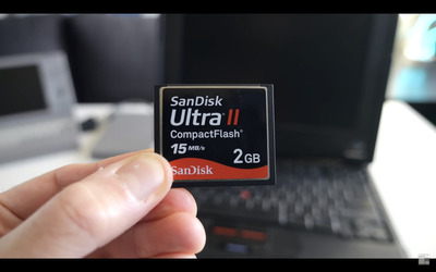

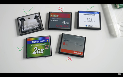

This little utility might be of help with some CF cards:
http://vogonsdrivers.com/getfile.php?fileid=1862
Not every CF card supports this; so your millage may vary .
Execute in DOS:
(To set the card to fixed disk/true-ide mode) If the card is on the primary IDE channel (which is highly recommended), type:
ATCFWCHG.COM /P /F
If the card is on the secondary IDE channel, type:
ATCFWCHG.COM /S /F
Revert:
(To set it back to removable disk mode) If the card is on the primary IDE channel, type:
ATCFWCHG.COM /P /R
ATCFWCHG.COM /S /R
Don't forget to issue fdisk /mbr afterwards;
Re-partition your CF with fdisk and then use the /MBR option of FDISK.EXE (from DOS version 5 or later) against the CF card:
on DOS prompt:
fdisk /mbr

I've already mentioned about ATCFWCHG back then. It used to work on some SanDisk ones but not anymore for new ones, at least the ones I have.
Though I'm curious if anyone ever succeeded with ATCFWCHG on non-SanDisk cards...

(Sorry, I posted late-night & somehow I missed it 😅 )
Here are two screenshots I saved sometime ago from a random YT video, presenting some CF cards that CAN be converted to FIXED with this utility:
This one can be converted:
The attachment this can be converted to FIXED.jpg is no longer available
Only the ones where I drew a green checkmark [v] can be converted:
The attachment FIXED=ok, REMOVABLE=bad.jpg is no longer available
