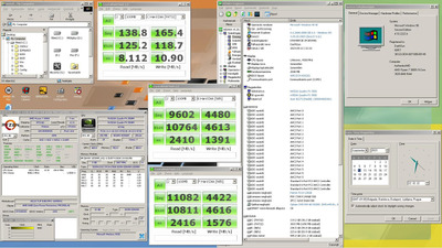

Turn to unimaginable speed under Win98 with SSD 😀
The attachment zen_98_ssds.jpg is no longer available
