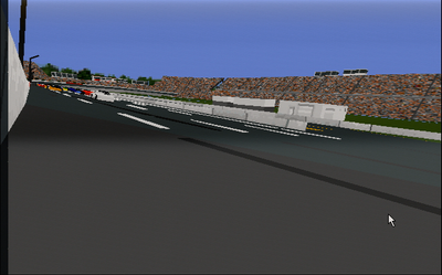

Reply 26 of 36, by 88mphTim
So I fixed it on mine by changing DVI adapter and I threw out the old one already do I can't reproduce. On mine there was a thin strip of darker pixels on the left side, and when anything white went into that darker area is streaked a wavy 'shadow' horizontally across the picture. So the walls, white lines on the track (in NASCAR Racing), the mouse pointer, etc, anything that went into that strip on the left streaked over on the right.
After changing DVI adapter that dark area on the left no longer exists.
I actually just found a picture, see attached. You can see the dark area on the left and the white wall also on the left streaking over on the right. In motion it looked like a wavy shadow streaking across. I'm assuming maybe there is some interference and my DVI adapter had poor shielding or something.
Reply 27 of 36, by rasz_pl
When I hear adapter I think passive. What you have is DVI converter, that means digitizing analog signal, scaling resolution, converting timings. Those have a strict list of supported resolutions/refresh rates and timing formats, anything outside will either not work or glitch. A lot can go wrong during conversion.
