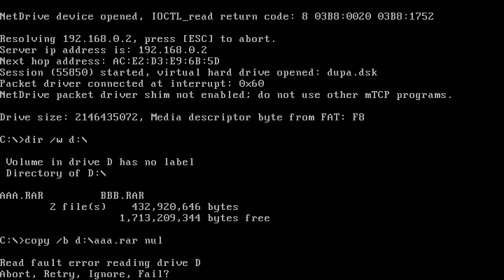

After replacing the PD with ODI+ODIPKT (attached):
- FTP download to NUL speed is 912 KB/s - yes, works fine, and even faster than with the PD
- NetDrive mounts the remote image, allows to list the files, but any attempts to read a file quickly end up with:
The attachment err.png is no longer available
The attached stuff is the simplest usage of ODIPKT - Packet Driver substitute, and nothing more.
But I also tried the setup with IPX support - same problem.

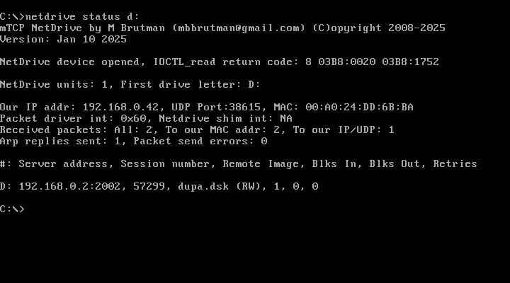

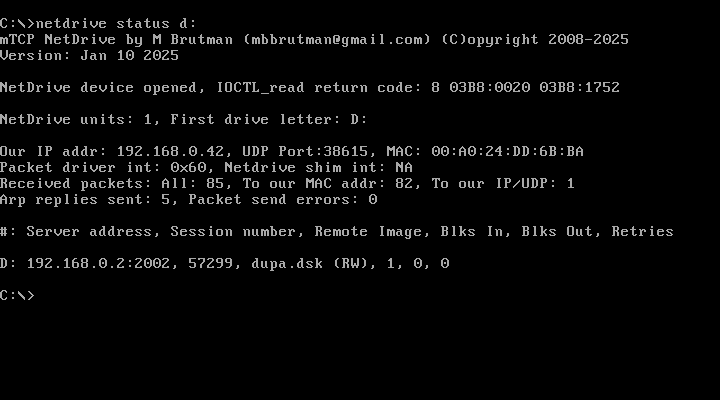

I did the following:
1. loaded ODI+ODIPKT
2. connected the remote image
3.
The attachment 1.png is no longer available
4. pinged the DOS machine from the server, where it was already in the ARP table - no response
5. pinged the DOS machine from yet another box - no response, but it got added to the ARP table
6.
The attachment 2.png is no longer available
Kiełbasa smakuje najlepiej, gdy przysmażysz ją laserem!

Ok, I didn't expect to see the ARP counter going up so maybe there is something else going on.
