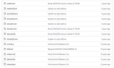

Reply 5 of 35, by DustyShinigami
LSS10999 wrote on 2025-02-11, 15:33:
DustyShinigami wrote on 2025-02-11, 15:13:
See, that was one of the things that confused me. I noticed that mentioned in another thread, but I don't seem to have any such file/driver. Nor did I see a command in the readme. I downloaded 3.09, which has Shsucdx.com and shcdx86.com. I don't believe I have DOSLFN. I take it that's an additional tool that allows longer file names? Thanks for the link to the documentation; I'll give it a look over. 😀
EDIT: Yeah, that was the same documentation I tried to decipher via the readme.
I think SHSUCDHD is from an older version then...? Judging from that linked documentation. That's 3.3, whereas I have 3.09. No such file is present.
The SHSUCDX 3.09 package contains only SHSUCDX.
There's a full package called SHSUCD 3-7 which includes everything including SHSUCDX 3.09. For loading images, this is the one you need.
Oh. So that's not the latest? I figured it was due to the date differences. 3.3 says 2005-2012 whereas 3.09 says 2006-2022. I'm wondering if 3.09 does it automatically...? I did download the one from GitHub initially, but that Master one was even more confusing. Too many files that don't look like I can do anything with in DOS. ^^;

Reply 7 of 35, by maxtherabbit
it has nothing to do with versions or release dates - what you're not understanding is that SHSUCDHD and SHSUCDX are totally different programs
SHSUCDX is a CDROM redirector for real (and virtual CDROM) drives just like MSCDEX
SHSUCDHD is a virtual physical layer driver for loading an image file as a emulated drive, and can be used without the use of SHSUCDX (by using MSCDEX instead)
Reply 8 of 35, by DustyShinigami
megatron-uk wrote on 2025-02-11, 16:14:
That's the source code. It's no good for your purposes.
You want SHSUCD r3-7 from here: http://adoxa.altervista.org/shsucdx/
Ahhh, gotcha. I guess I thought that top one wasn't applicable for some reason and wound up picking 3.09. ^^; Thanks.

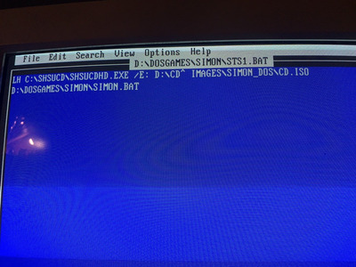

I’m a bit lost at getting DOSLFN working, though I now have it on my system. I’ve not been able to add quotations when editing my batch files under DOS, so I’ve had to type words out followed by ‘^’ as I understand that’s the alternative…? So like “My Documents” becomes My^ Documents…?
I’ve added the initial command in my autoexec.bat file so SHSUCD is initialised when loading DOS, but I’m guessing that command you’ve shared is for the game’s batch file, right…?
I’ve tried adding it so it reflects my drive set up (physical F to E), but I’m still not having any luck getting it to mount/load. I’m guessing the directory of SHSUCDHD.EXE needs to be listed like I’ve put otherwise it won’t know where to look…?

Reply 12 of 35, by megatron-uk
You've got spaces in your cd image filenames.
https://www.target-earth.net
Reply 13 of 35, by maxtherabbit
yes the caret is not a valid alternative, the image file needs to be specified at a valid 8.3 path
IIRC for a directory named "CD IMAGES" the resultant 8.3 path would be "CDIMAG~1"

Reply 15 of 35, by DustyShinigami
Still no luck so far. As a test, I’ve created a folder called ISO on the D drive, in there SIMON_DOS, and then copied the ISO. So it’s D:\ISO\SIMON_DOS\CD.ISO
In the autoexec.bat file, I’ve added:
LH C:\SHSUCD\SHSUCDX.COM /D:MSCD001, /L:E
LH C:\SHSUCD\SHSUCDHD.EXE
Both load up when DOS is initialised. Though I’m still having no luck at mounting the CD image in the custom batch file. So at the moment it’s:
LH C:\SHSUCD\SHSUCDHD.EXE /E:D:\ISO\SIMON_DOS\CD.ISO
LH C:\SHSUCD\SHSUCDX.COM /E:SHSU-CDH
D:\DOSGAMES\SIMON\SIMON.BAT
It’s still not finding the ISO though. 😕
EDIT: Changed ‘SIMON_DOS’ to ‘SIMONDOS’. Now have the batch file as:
LH C:\SHSUCD\SHSUCDHD /F:D:\ISO\SIMONDOS\CD.ISO
It says Unit 0 (warning: file size differs from volume size)
It says the SHSU-CDH CD image driver is installed. But having LH C:\SHSUCD\SHSUCDX /E:SHSU-CDH doesn’t appear to be doing anything. And it still doesn’t recognise an image being present.
