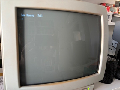

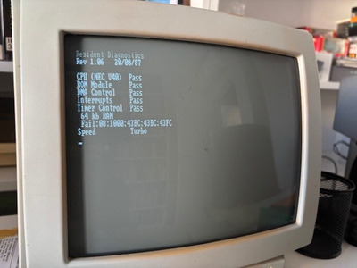

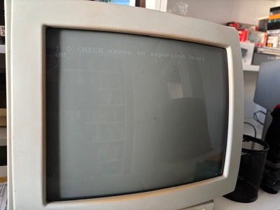

Hi!
I recently bought the "PicoMEM - Audio Edition" version from Serdashop, but I seem to be having trouble getting it to work on my Olivetti PC1.
When I use it on one of the ISA slots, it halts the memory test with a "Fail:08:1000:43BC:43BC:43FC", followed by a clear screen, change in resolution and a message "I/O CHECK error on expansion board 00".
If I try it on the other ISA slot, I get the error "Low Memory Fail", even before going into the boot screen.
I have attached photos for reference.
Any idea of what I can do diferently?
Thanks
