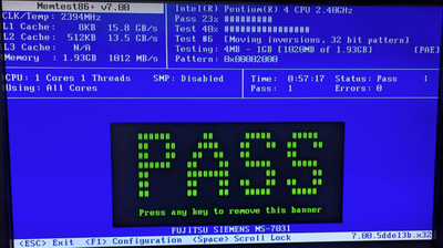

Instead I got another µATX Board which is already up and running and my build is almost completed. The board I've got is an MSI MS 7031 which to my knowledge is from a Siemens Scaleo P from around 2004/5. The Board itself comes with a rather interesting Chipset made by ATI and supports 800FSB Preshot P4's. I didn't found much about the board and it's history but I saw one review mentioning the chipset performing better with Preshot than Northwood which is kinda unusual but good enough for my 'lonely' P4 530J to have a new job now.
Everything went smooth so far yet I seem to encounter some sort of weird latency issues. One time after a cold start I can play games without any problem and then suddenly the whole game stutters and becomes unplayable - every game I have tested so far shows this behavior. First I thought it may be a dodgy GPU driver so I did a clean install of catalyst 6.2 but same problem presists.
After digging a bit deeper I found out that the RAM is acting up all over the place. Suddenly EVEREST and AIDA64 shows me around 312ns of RAM latency in the benchmark section which puts the system on the last place of the list, performing worse than a K5... The same goes for bandwitdh and copy benchmark.
I've swapped out the RAM with a pair of ELEXIR DDR 400Mhz which I had used in my Dell GX270 and the results went back to good until I start to "stress" the RAM by either playing a game or doing a benchmark. Memtest says the sticks are good which you can see in the pic below but the transfer speed seems pretty low for Dual Channel.
In the bios I can choose between interleaved mode "Gaming and optimal system performance" but none of them do really any difference. I've set timings manual but no change.
here are the system specs:
MSI MS 7031
P4 HT 530J (3,00/1M/800)
2GB DDR 400 dual channel
ATI Radeon XT 2600 Pro
SB 0460 X-FI
Win XP Pro SP3
