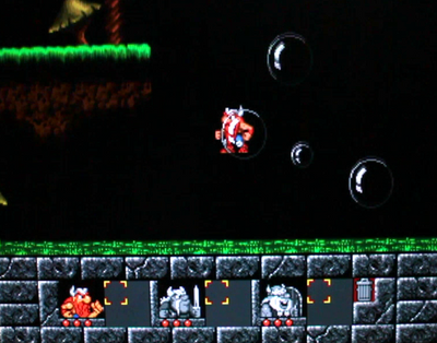

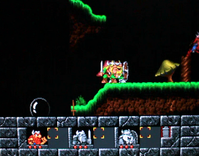

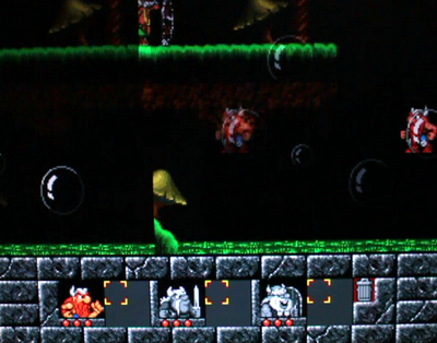

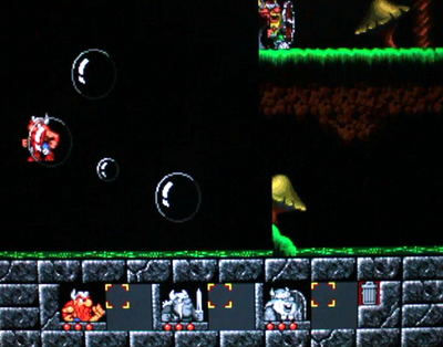

Reply 34 of 42, by tauro
ViTi95 wrote on 2025-03-09, 13:10:
My guess is that they focused on performance for VESA modes, as they are faster and easier to work with. All other modes were merely emulated for backward compatibility.
I see. It shows a lack of seriousness and commitment. But probably the budget was low.
I can't understand how you can emulate older modes and if there's a way to change the way that older modes are emulated. Could it be done with a TSR? The video card is far more capable and it's disappointing that it's glitchy with such basic stuff.

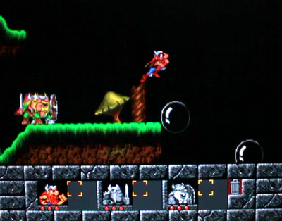

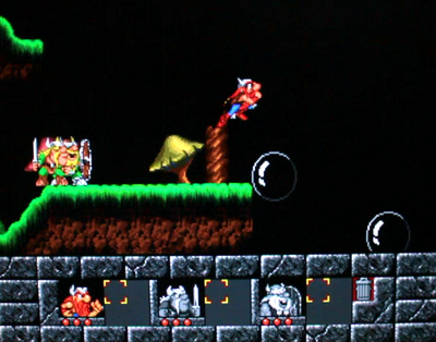

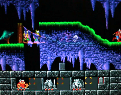

Here's a demo of what the bug looks like. I let the demos of The Lost Vikings run and recorded it.
Most of the time, everything is fine. But sometimes, it could take 30 seconds or 5, an image from a different place of the level appears (from a different region of memory?). It briefly appears and disappears. This happens all the time with many games, but not all. So they are playable, but it gets annoying.
Some important bits of info: the same demo doesn't always glitch in the same part. I think this may be significant.

Example 1
Frame 1
418.51 KiB
161 views
Frame 2
398.36 KiB
161 views
Frame 3
390.37 KiB
161 views

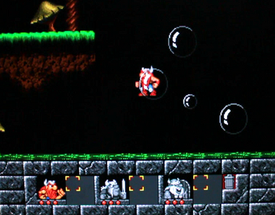

Reply 36 of 42, by tauro
Example 2
This time it goes one way and then the other way, before it returns.
Frame 1
403.32 KiB
159 views
Frame 2
390.56 KiB
159 views
Frame 3
390.04 KiB
159 views
Frame 4
376.27 KiB
159 views

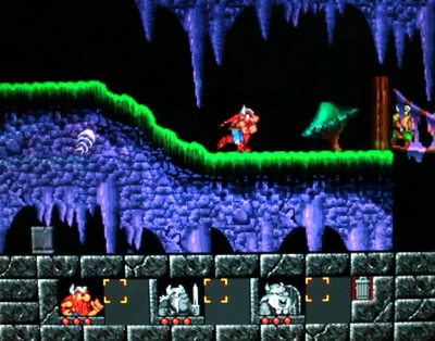

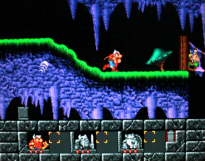

Reply 37 of 42, by tauro
Example 3
Frame 1
615.77 KiB
158 views
Frame 2
606.57 KiB
158 views
Frame 3
579.53 KiB
158 views

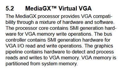

Reply 39 of 42, by ViTi95
tauro wrote on 2025-03-18, 17:49:
16.88 KiB
114 views
Cyrix MediaGX Virtual VGA
6.54 KiB
114 views
Cyrix MediaGX Virtual VGA 2
Basically they use the CPU for certain operations, which slow everything down. There isn't much more information about how it really works. Also seems not everything is 100% implemented.
