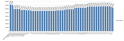

Versions 1.1.2 and 1.1.3 have been focused on optimizing the size of the executables and RAM usage. The executables had a lot of text that was only used once and took up unnecessary space, so I decided to extract it and place it in this /TEXT folder. The same thing was already done with the INTER (now unified into TEXT) folder and the intermission scene texts, and there were no complaints about it. Like with any game, if you delete the game files, it will eventually stop working, this is the same. It’s true that I could try to unify them so there are fewer separate text files.
There are also possibly other ways to optimize the .exe files such as different compilation options and optimization levels and / or different compilers (Watcom produces smaller compiled .exes than DJGPP, for example). However, the focus on FastDOOM is *speed* not necessarily optimization, which often -- seemingly paradoxically - reduces speed. As noted above, having many seperate files as adjuncts of the .exes now slows the loading of the game down, especially on older hard drives. Whereas before you had everything in one .exe file, once that and the .WAD was loaded, you didn't need to do any more seeking on the hard drive -- at the slow millsecond range verses the nanosecond range of pure RAM access.
I'd still urge you very strongly to reconsider putting all of the data in those other directories back into the exe. It will increase the .exe size by, at the most 50 kb or so. Well worth it. (I did notice the other /INTER directory of course, but if this directory is deleted, the game still runs, doesn't break and / or make it impossible to quit and return to DOS!).

I'm totally fine with extracting text from the executable, as long as it's only used once or in non gameplay related cases. A smaller executable and reduced RAM usage are big advantages on systems with very limited memory (i.e., 4MB or less), as this also lowers the number of in-game hard drive reads. I'm careful not to optimize anything that could negatively impact in-game performance.
For FastDoom 1.1.4, I'll be consolidating all these small text snippets into a single file, which currently takes up around 14KB. I'm not using an additional WAD file because I want to avoid increasing RAM usage due to extra file indexing.
