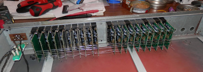

I'm turning a dead EQ into a 10x stereo input mixer, with differential inputs to successfully deal with the inevitable ground loops that form between all the computers that this thing will connect to. Tomorrow I'll build a power supply section and the actual mix amp, neither of which I got PCB made for but perhaps should have 🤣.

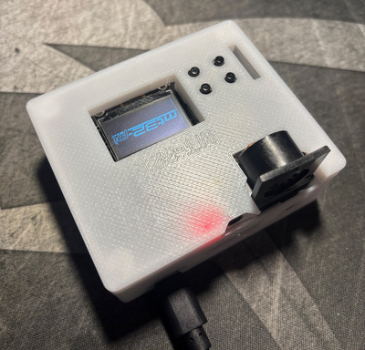

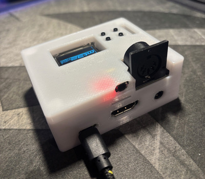

I have just completed my MT32-pi project, which included assembling the MIDI Hat and a 3D-printed case. Thanks to the interwebs!

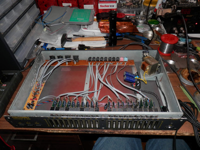

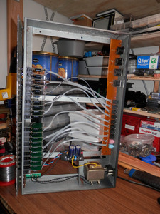

The mixer has all inputs connected now. It took some effort to get the holes drilled and in the end they ended up a little offset still...
Next up is making the summing amplifier and output buffers. This thing will feed monitor on the desk, amp on the desk and output to the big amp in other side of the room and one output will be spare. I'll make outputs all differential too.

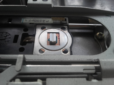

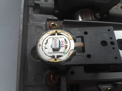

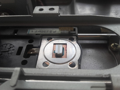

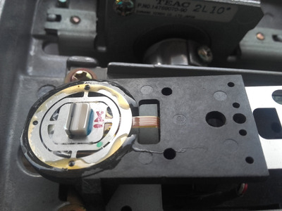

Cleaned the heads of a 5.25" FDD (TEAC FD-55GFR), which were contaminated with magnetic film from some old rotting diskettes. It caked up so hard that even a cleaning diskette couldn't deal with the dirt, so I had to completely disassemble heads and scrape that stuff off.
Interesting observation - I tried to align heads using IMD alignment test and the drive passed it with a formatted HD diskette, but in reality, the FDD was still unable to read formatted DD or HD diskettes, so I had to align heads the old-fashioned "trial and error" way.
Did I miss setting stomething up in IMD regarding 5.25" drives, because with 3.5" drives, IMD has always been accurate in alignment tests.
This is an inconsistent statement "aligned with IMD .. drive passed" and "was unable to read DD or HD disks"
IMD Test/Align does not write the disk - it reads the disk and beeping indicates when it could read the sectors
on a track matching the selected track...
So how could it "pass" alignment if it couldn't read the disks?
To align with IMD, you have to have a formatted diskette of known good alignment (I usually use some commercial
package distribution disk) - ** That matches the drive (DD or HD)
You step to a track, move the heads to the edges of where it can read the matching sectors, note positions
and clamp it down in the center of that range... rinse and repeat on various tracks over the range of stepping
till you find the best compromise...
If it can't read the disk, would never indicates that it could read sectors... so how could you figure out where to clamp
it down.
Another possibility - double-step setting should be OFF, use 40 track (360k) "master" for 40track (DD) drives,
and 80track "master"for 80-track (HD) drives - if you have any of these wrong, things won't work out.
IMD doesn't know of care about 3.5" .vs. 5.25" drives - it just knows stepping and data rates... the main difference
between 5.25" drives is that there are both 40 and 80 track drives where all 3.5" drives are 80 track!

Thank you for the lengthy explanation, I think I figured out why I was getting perfect readings from the alignment test despite the upper head being misaligned - I was most likely checking the alignment of the lower head instead, because when I moved the upper head around, the number of sectors being read did not change at all, uh oh...

Good point, and I did forget to mention that as you are moving around tracks to test, you should also
be changing 'H'eads - not something I (and most others) normally think about as the heads on most
drives are so well fixed relative to one another that you don't have to concern yourself too much
about aligning both...
But, since you removed the upper head, you would have to align them independently which can
be a bit tricky .. I'd align the bottom first, then hopefully the drive will let you loosen the upper
one enough to move it a little while you test .. otherwise you would have to do power down, adjust
and try to note the positions of the upper while finding the outer limits...

But I only recognized that after I "freed" the disk in some way (naturally you can't see this knob when a disk is inserted into the drive).
With that "freeing" action the disk must have hooked into the upper head in some way and twisted the metal sheet where the actual head is mounted on a little too much.
It ended in the removal of the upper head to "correct" this deformation but I could never realign it correctly again.
Like Kahenraz wrote it is absolutely delicate to get the head positioned right again, especially in relation to the lower head, and after the final fixation it could still be misaligned (again).
I still wonder how they did in the factory.
I found only some little information about the functional work of a floppy in the net, with things like track width, radial offset between upper and lower heads and stuff and didn't see why the upper head wouldn't work again and spend hours with trial and error (and IMD) but eventually I gave up and the drive went into the parts bin.
Lesson learned: NEVER remove heads of a floppy.
RetroPC: K6-III+/400ATZ @6x83@1.7V / CT-5SIM / 2x 64M SDR / 40G HDD / RIVA TNT / V2 SLI / CT4520
ModernPC: Phenom II 910e @ 3GHz / ALiveDual-eSATA2 / 4x 2GB DDR-II / 512G SSD / 750G HDD / RX470
Reply 29317 of 32089, by Kahenraz
I also wonder how the aligned the heads, especially with this laptop drive I was working on, because the head pivots slightly when you tighten the screw down. I ended up tightening lightly and then adding glue on top to prevent it from coming out from any vibrations. I also tweaked the alignment so much that the head started to tilt. I fixed this by slipping a folded piece of paper in the mechanism to raise one side slightly. It was such a mess. Anyways, I got it aligned (somehow) and it seems to be working fine so far.

Tiido wrote on 2025-02-24, 12:59:
Ha, that's a pretty neat project!
I probably could use something like that myself.
Instead, I've been doing it the manual way for longer than I can remember now: each PC has a 3.5<->3.5 mm cable plugged in its Line Out jack, and all of the ends from these cables are on top of my desk, to be plugged/unplugged manually either directly into a pair of headphones, or through my headphone amp (and into another pair of headphones.) I used to have "bookshelf" speakers at my old place too... but this has been on the "wait list" for my new place/setup.
In regards to ground loops, I've never had issues with that back when I lived in the US. But here in Europe, I have seen it a few times at other people's houses and even have a monitor that buzzes rather loudly (probably) due to a ground loop.
I wonder if just using a somewhat low value resistor between the ground of the output device and the ground of the receiver device can correct for this. If I recall, this is what some PSU manufacturers did to minimize ground loop noise for audio.
Tiido wrote on 2025-02-25, 08:30:
Did you use a smaller (well, the smallest you can get) drill bit to drill their centers first? I typically use a 2 mm one to get the centers drilled out, then move up to either 4 or 5 mm, then up to 8-10 mm... and widen once more for larger sizes.
Tiido wrote on 2025-02-26, 11:13:
I also had to reorient the power transformer since there was a strong hum in the sound that didn't react to moving or shielding other things in the device.
At least you have plenty of space for that inside. 😀

ChrisK wrote on 2025-02-27, 10:14:
Wish I read or asked about this a month ago. 🙁
I had a really dusty and dirty PC roll through. So every single component had to be taken apart for a wash, including the floppy (which had sucked in a lot of dust.) When I started taking that apart and got the the head part, it did cross my mind that perhaps this might mess up the alignment. But I figured, if the heads were held together with only 1 screw that was easily made to be removable, then surely this shouldn't be an issue. Guess I was quite WRONG on that. 🤣
We will see, though - I haven't tested the floppy drive yet. Maybe I got super lucky and it's all working fine. TBC... :p:
