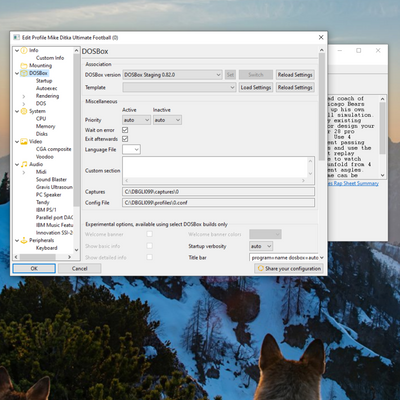

Newcomer to DBGL. The game in question is Mike Ditka Ultimate Football from 1991. In Dosbox Staging I get sounds, voices and mouse cursor but in
DBGL with Staging used for dosbox version the voices sound muted and mouse use is not there. Do you know where in the config file I can tweak some things
to get it to work? The machine emulated is a 486, 16mb, S3, SB16. In stand alone Dosbox Staging I used the "base" settings.

Reply 2084 of 2132, by buckeye
buckeye wrote on 2025-01-20, 17:31:
I'm not sure, but you make it sound like you're using one of the available Templates for your Football game. If so, just start by reloading DOSBox's default settings (Edit profile, DOSBox, Reload settings) and go from there. I believe this particular game should just about run fine using the defaults.
It's working now since I reinstalled everything. Another question: when you select machine type and hit ok it seems like it doesn't retain the selection. I'll go back
in edit and the template selection is blank (see attached pic). Any suggestions? Thanks for getting back with me, hope you're feeling better.
Reply 2085 of 2132, by rcblanke
Thank you buckeye, yes, feeling better! About the template setting - correct, this association is not retained. A template is simply a collection of DOSBox settings, which I do not consider to be of importance to be retained. A template can be considered a starting point for a profile. Please note that a DBGL template usually entails more than just DOSBox' "machine" setting - for example, soundcard settings are usually included as well. You can check the contents of a template using right-click -> View -> Configuration File. Also note that the included templates are really meant to be used with DOSBox 0.74, they may or may not work correctly with a DOSBox fork such as Staging. If you do intend to use templates with DOSBox staging, I would recommend you create your own templates based on your own DOSBox versions.

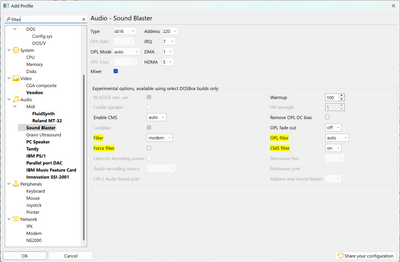

The attachment Screenshot 2025-02-21 182322.png is no longer available
Reply 2096 of 2132, by Monotremata
